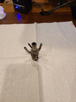

to get ported vacuum you need a port above the throttle plates. You can pick up manifold vacuum usually at the back of the intake manifold and use a fitting similar to this one,

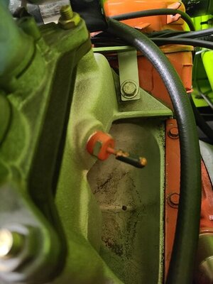

1mean66 I hope that tarantula looking vacuum fitting didn't sway you away from the intake as a source for vacuum advance. Those fittings come in many shapes. I attached a pic of the one on my 6 pack manifold. Most manifolds will have a 3/8 inch pipe thread port for vacuum to operate power brakes and other accessories.
