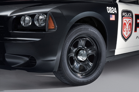

Hey guys,
I have been eyeballing the local authorities wheels and want to see what they'd look like on my car. If anybody has a set or knows where to get them inexpensively please post or PM me.

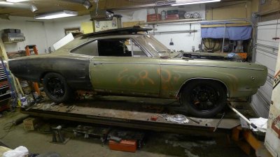

They do bolt up, as for the offset the front fits fine but the back needs 1.5" spacer. I borrowed my buddies wheels to try out, personally i think the fronts look a little big
