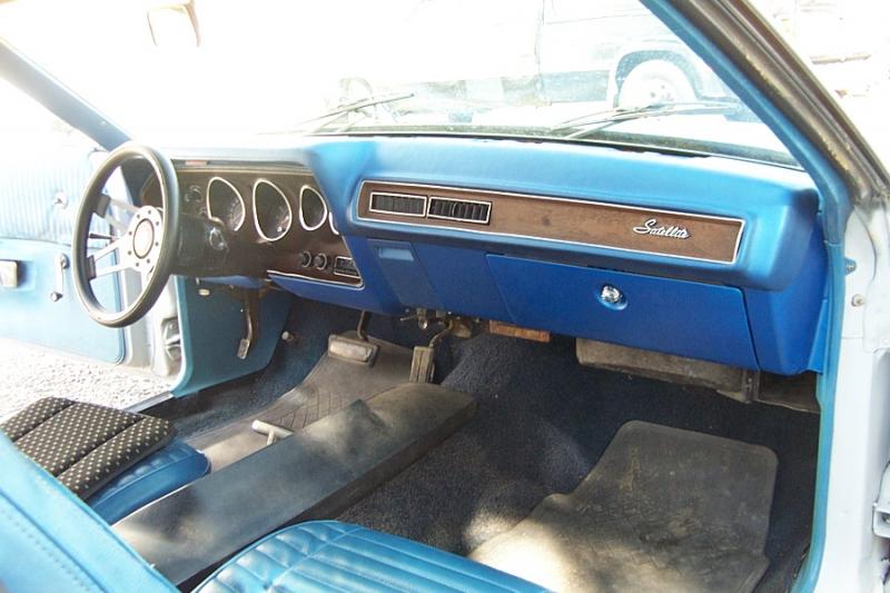

Thank you - hood now works. Could someone post a pic of their RR heater blower so I know where it is?

if i am not mistaken it is here (outlined in red).. Mine didn't have one, but the guy installed before i picked it up.

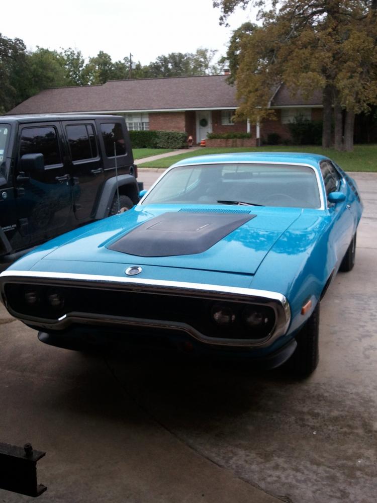

front end pic is dark...does it still have the illusive 72 RR grill inserts?
If you mean the little RoadRunner standup decal that sits in the grill - yes. I will post more pix.
See the black box below the grove box. Thats the heater box. About 2.5' long and takes up the whole pass side of the under dash.
There is also a vent box on the drivers side by the EM brake.
