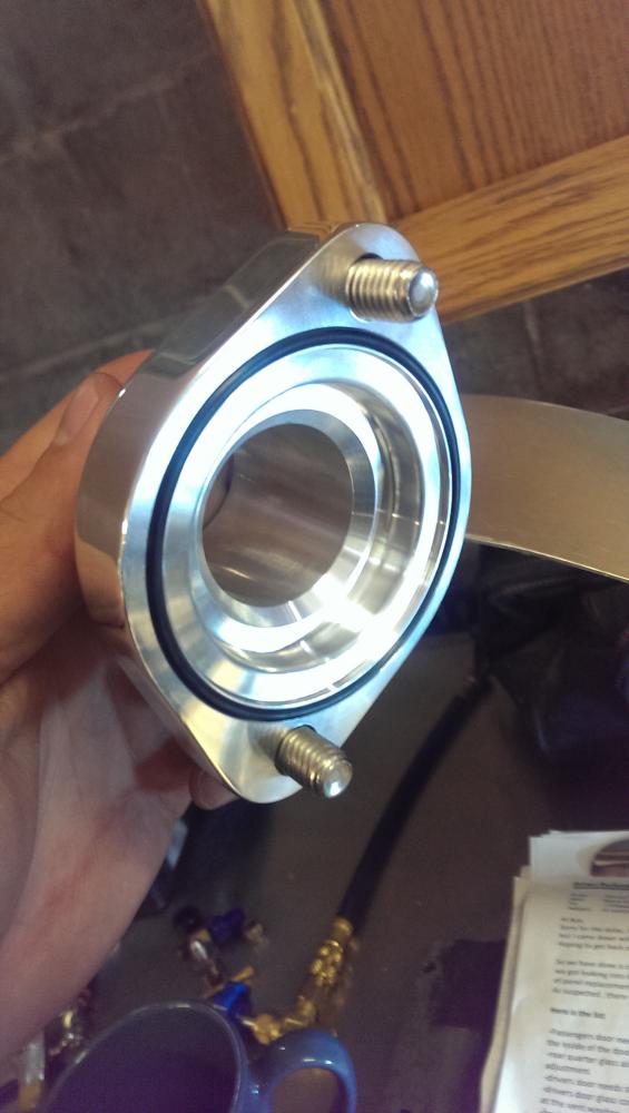

IMAG4689.jpgI did a billet with the O-Ring seal by Billet Specialties. Still used some Permatex but solved a leak issue I've had since day 1 with this motor.

The Billet Specialties neck with the o-ring is AWESOME. Bolted it on as is and no longer have a leak. Worth the money I think to be leak free.
