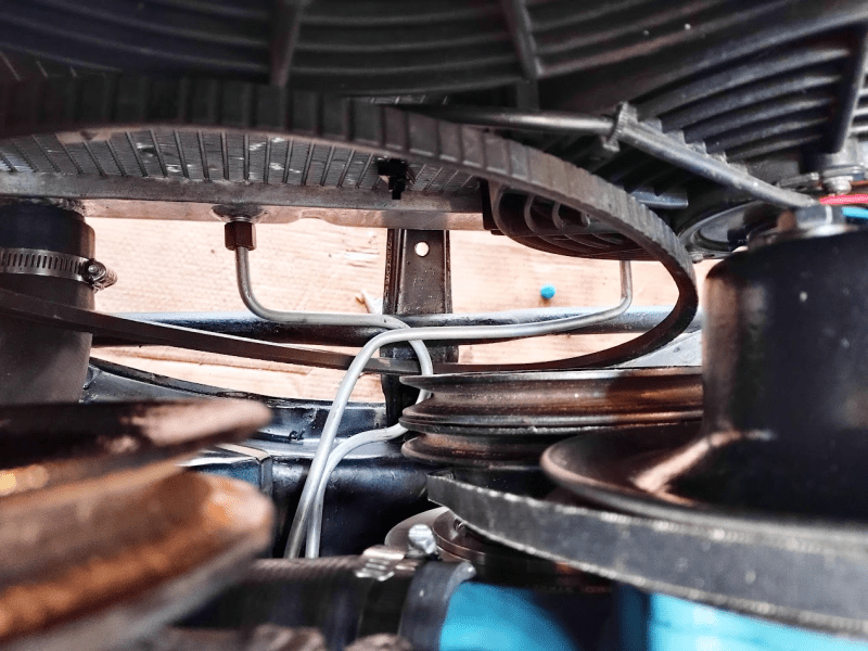

What are you working on? Year, engine, any photos, might help us, help you.

Its a 72 Satellite with a 400. Power Steering and Air Conditioning. I don't think there will be room for the hose on the Drivers side. Grr...

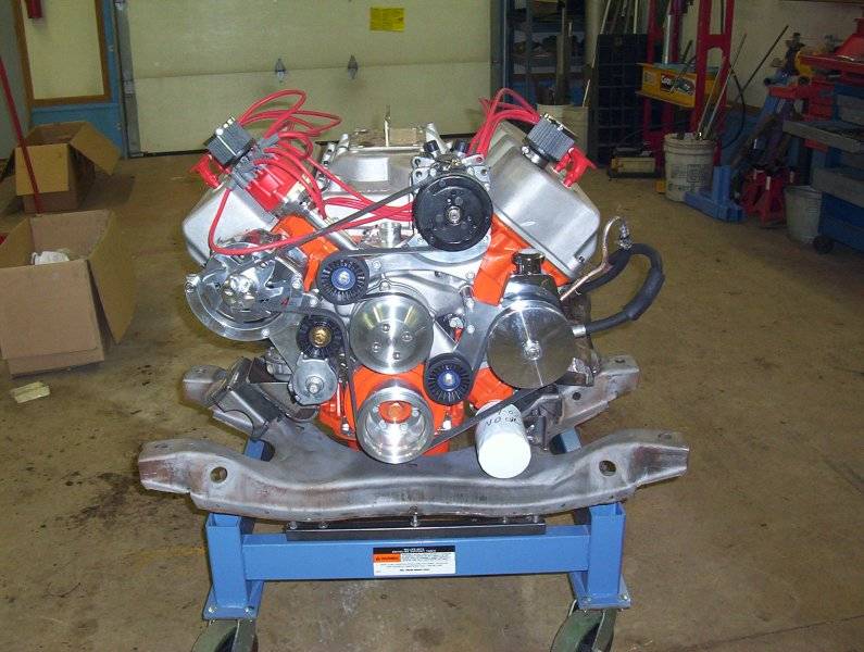

My 69 Charger with a 528 hemi has everything on the drivers side.

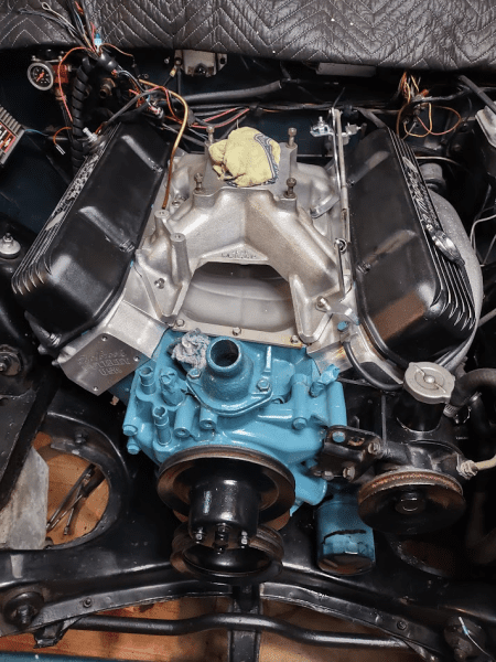

Could I get a picture of how everything in run? Thanks!
Well, thanks. Not exactly what I had in mind, lol. Your engine is this beautiful modified machine. I was hoping for a picture of a more stockish looking motor with the outlet on the passenger side.
Here's one. (Extra credit if you can tell why I took the picture)
I don't get it. In your first post you said you had a drivers side pump outlet and a radiator for the drivers side also. You thought there is not enough room for everything to fit. I offered a photo showing everything does fit. Gates 20609 hose is all you need and 2 clamps. You asked for a photo. Everything you have will work so whats the problem.
The hose squeezes through between the belts? That's a tight one.
I agree, go drivers side. The p/s pulley is the area to look at , if any
