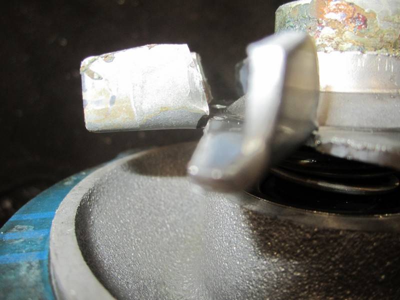

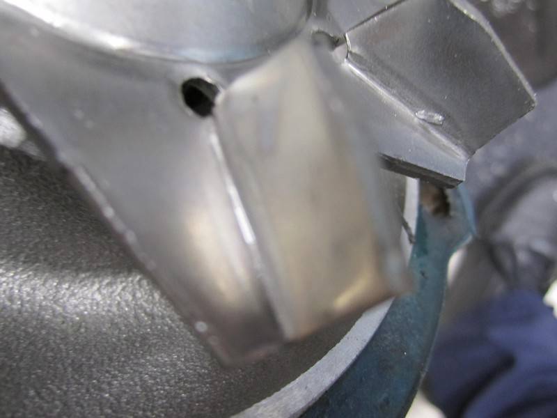

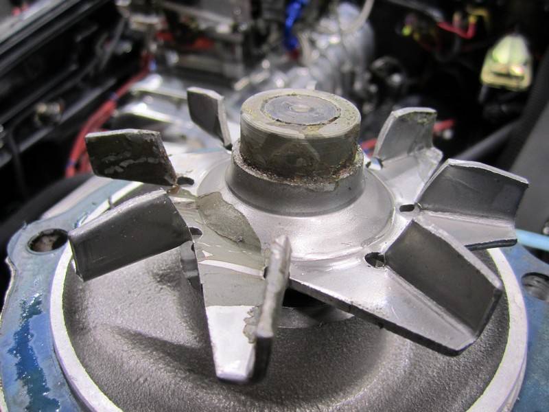

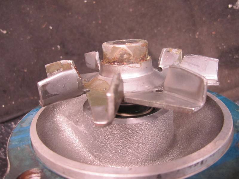

Well if it was me I'd take it back off and make sure the vanes aren't contacting the internal passages at all. Sometimes with these aftermarket pumps you need to use a thicker gasket. Then I'd dribble some coolant in the back of it to lubricate it, and spin it while listening for any strange noise. Easier to check and/or replace now, than later! For what it's worth I'm not real impressed with Flowkooler. One of the more expensive pumps out there, and while it did lower my running temps a bit, it started dripping intermittently out the weep hole after 6 months on the car..

Zack,do you have pictures of the vanes on the FLO? I always used the aluminum MOPAR A/C pump. Keeps my brick cool.
This is from their website...maybe mine leaks because it got one of those aluminum shavings in it?:D
