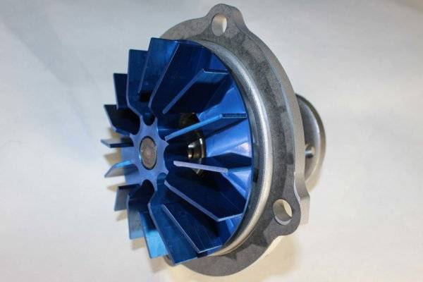

It is not really weird. The cast blade is curved the steel is straight. The cast blade has more clearance on the pump casing, the steel blades have less. Plus why would you want to add weigh to motor when not necessary for increased performance? G
Does the fact that the cast iron impeller sits deeper in the hole when mounted to the pump housing make it flow less water? (see side by side photos above)
I've liked at several articles about this and being in Texas where we typically have 2 seasons ( hot and hotter) I decided to go with a FlowKooler...impeller design and numbers look legit...
Motor is still in parts, so I can't really say...Curious to know how it went?
Not so. The diameter of the fan belt pulley determines the speed at which the shaft turns, not the impeller diameter. If your rotary vane pump is from 440 Source, the back of the impeller is VERY close to the inside of the water pump housing and requires a 'thick' gasket to provide clearance (extra cost). Also, if you use their stainless steel water pump bolts and have an aluminum housing make sure you use anti seize if you ever want to remove them. I am curious as to why the Milodon pump impeller assembly is so much shorter. I have the Mancini water pump housing and the Milodon pump on my car and they work fine. I remember checking the impeller to housing clearance and it was about .050-.060".
I had been using the Milodon HV pump and it works well. I switched to the Flowkooler a few years later after an extended 30 min idle in a traffic jam made my engine coolant temp climb from 185F to 215F. The Flowkooler's higher flow lowered my idle temp by almost 10 degrees F. At speed they've both performed about the same for my mild big block build.I didn't see the FlowKooler pump tested. Does anybody know how there design stacks up against the Milodon HV. Milodon is less money. The FlowKooler is about $50 more. Is it worth it?
