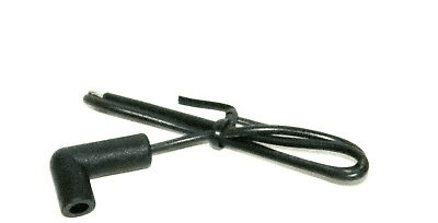

should have a wire like this

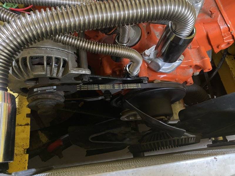

Here’s a shot of things now…
Lookin good! The lower alt adjust arm should go behind the triangle bracket, and the bolt behind the fan belt should have no washer.
Getting there!
And the bolt on the front of the drivers side head should have a ground wire on it...
You should clean the paint off that area threads underside of where the wire goes etc.
