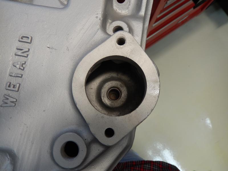

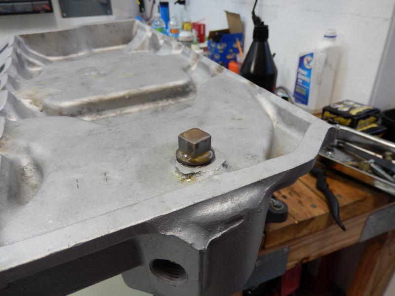

I have a Weiand 7503 aluminum manifold that I'm using on my 65 poly build. I bought it used a couple of years ago and just went to test fit it in the engine. There is a plug in the intake floor below the thermostat housing that someone plugged with what looks like a plumbing pipe plug with a square head. The problem is the head hits a casting boss in the lifter valley. I'm sure this was meant to be plugged with a hex head style plug, or at least inserted from the top.
The problem is that it won't come out. I put the intake in a vise and used a long breaker bar but it won't budge. I PB Blasted it and let it set for an hour, still won't move. Tried whacking the wrench with a mini sledge, no go. I think it may have been stripped. So the question is, would there be any problem cutting the head off flush with the bottom of the intake? I don't know why it's even there, so I can't think of why I'd ever have to remove it since it would open a coolant passage into the lifter valley?
But, these intakes aren't made any more and there are no others made for a poly. Used, these are now going for $500-$700. So I don't want to screw anything up. Does anyone know why that hole is there and if it would ever need to be opened?

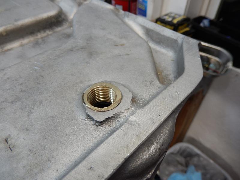

Well, I tried to use the heat today. Did no good. I heated it to about 400 degrees, per the infrared thermo. Tried to cycle it hot to cold 4 times. It's about 35 degrees here today, so I heated it and then set it outside for a while. Tried it with the impact, just rounded the corners. Even tried the wax trick that CudaChick recommended. I don't think rust is an issue, it's an aluminum manifold and with a brass plug (I think).
I don't think there's any doubt this was cross-threaded, so I cut it off and tapped it as you can see in the pic. I'm not much of a fabricator so I was pretty proud of myself until I tried to put the hex plug in. It wouldn't go. I knew the size and pitch were correct but after thinking it through, I realized the plug is an NPT thread and my tap is standard. Crap. Tried to find a 5/8 thread bolt at the local auto parts and hardware stores. No one has one that big in a fine thread. So I guess I'd have to order it online.
I know the best course is to find someone to drill it and weld it up, but I took this week off to try to finish this engine. I don't know how long it will take me to find a shop to TIG it. But it'll probably cost me another day at least. So I had another thought. I ran all of the air lines in my shop myself, including sweating the pipe. Could I solder or braze this up? If I filled the hole with solder flowing into the threads, it seems like that might work. What do you think?

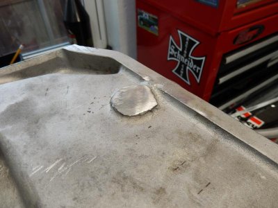

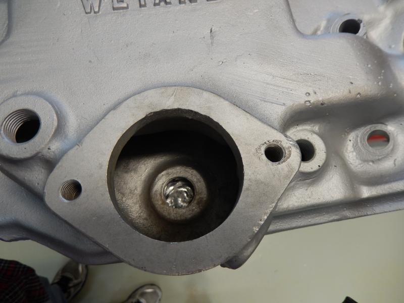

Thanks for the offer and the advice folks. I got lucky and found a machine shop about 10 miles from me that can weld it up today. It's over there now.
Uh-oh. Can't remember the shop's name, but they did welding on my trans case. Took 2 weeks, and only got it done while I was standing there. Could of done better job in my sleep!
Maybe you'll have better luck!
The name of the shop was Hooks, but no worries. Just got back with it and it looks great. The machinist told me that the reason I couldn't get the plug out was that it had been epoxied in. :confused5:
