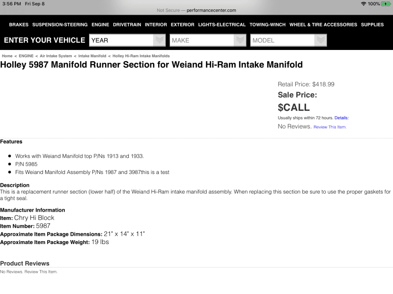

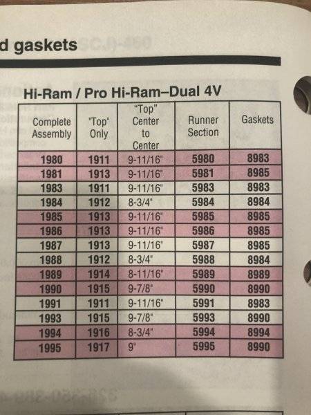

I think people see the “5987” on the lower piece and think that’s the number for the complete unit.
I think the “1987” is a 1913 top, with a 5987 bottom.
That makes a lot of sense, thanks!

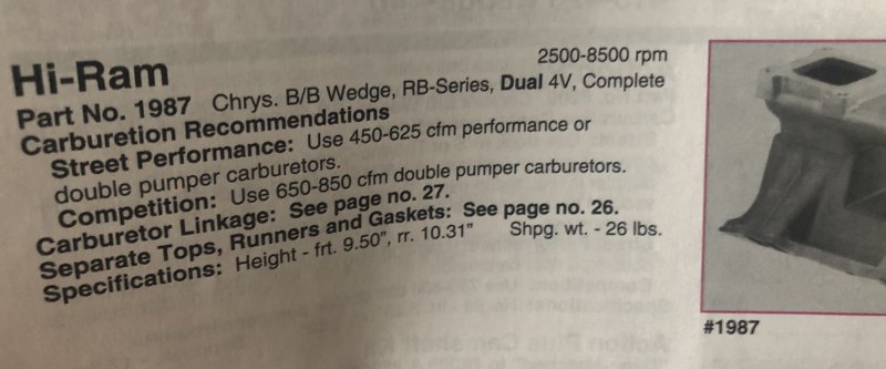

Features:1987​
  • Carb Flange Center-To Center 9-11/16"
  • 2 x 4 carburetor top
  • Square flange carburetor mounting
  • 2800-8000 RPM power band
  • Special D-shaped port runner design
  • Large volume plenum
  • Height: Front 9.50", Rear 10.31"
  • Port Size: 2.14” height 1.12" width
  • Weiand Nostalgia Series Intake Manifold

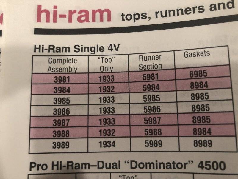

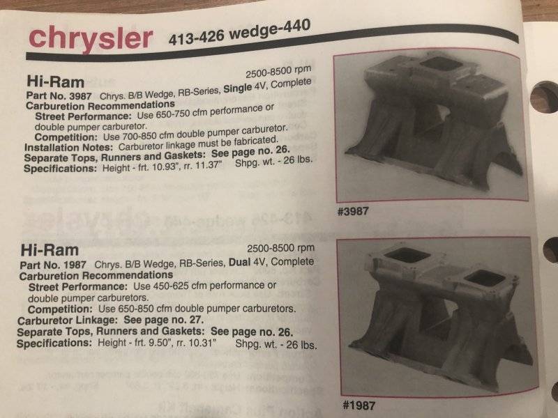

Since you have the catalog, what does it show for the lower half part numbers on page 26?
....And once again,
PRHeads nails it!
He'd earlier suspected what the catalog confirms. Thanks again Dwayne!
