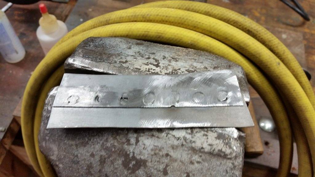

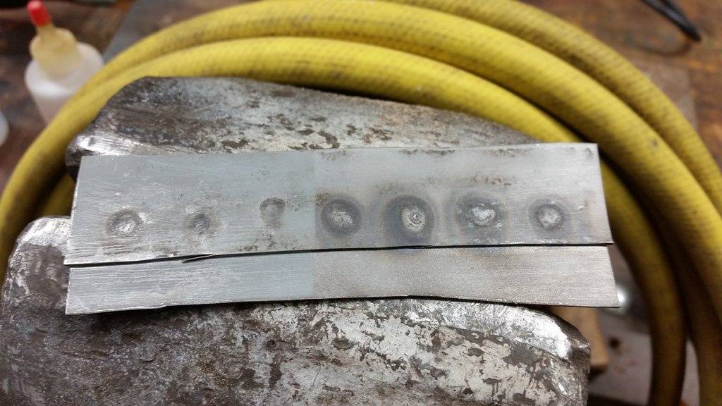

So whats the deal with weld thru? It totally messed with me on plug welds. I've read this and that, but folks say it should work. Didn't work for me....totally blew out the outer layer of metal and messed up the welds.
Did this test piece and the the half with primer turned out slightly better, but still sucked, the 4 on the other half were clean metal. Look at the penetration on the back. I know your suppose to turn up the heat some but **** just blew up more.
I was using some spray bomb NAPA zinc weld thru primer.
