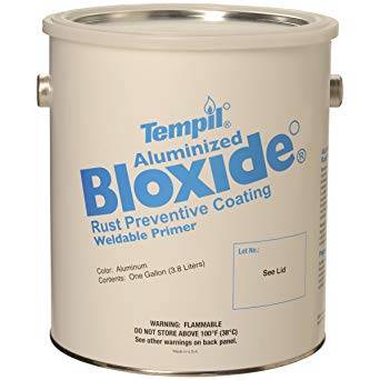

I use this everywhere I weld...... if you wait for it to dry, its awesome
the aerosol cans are very pricey, a quart of this lasts long time Joe
