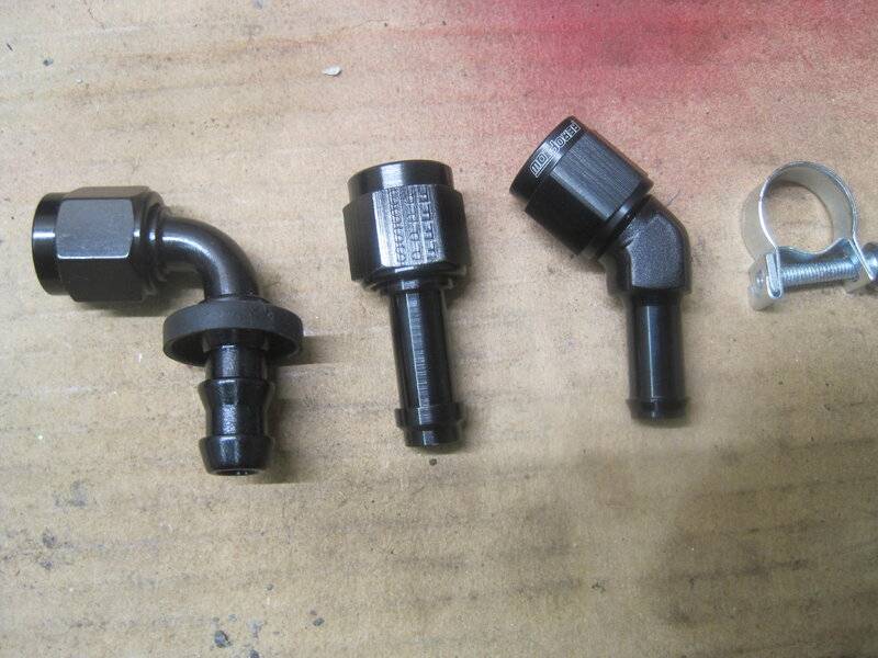

So I was bound and determined to reuse the existing fuel lines. The only line I had to make was from the fuel filter to the regulator, and I was dreading the moment. But then my neighbor stopped by (same one mentioned earlier) and showed me the fittings FiTech sent him for his install. The company is Aeroflow, based in Australia and unfortunately they don't have a US distributor. It took 10 days for the fittings to arrive - not bad considering. However, I was able to seat the fittings in about 30 seconds. These fittings require an EFI rated hose clamp; the push lock don't require any clamping.
Here's three types of fittings: Left is the push lock (unknown brand), center is Earl's EFI rated and right is the Aeroflow.
Although the Earl's has only one flare, its' still a bear to seat the hose. If you plan on using push lock, consider investing in this tool by Koul:
It's a little pricey at $279 on Summit but it will seat the fitting in a minute. Realistically it will take 20 minutes per fitting to seat a push lock without a tool, times the number of fittings and it becomes an entire afternoon job, assuming your fingers and hands don't give out first.
