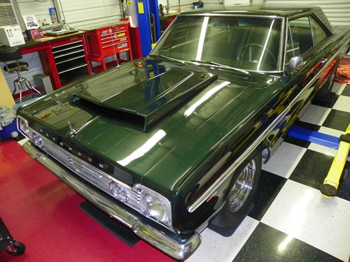

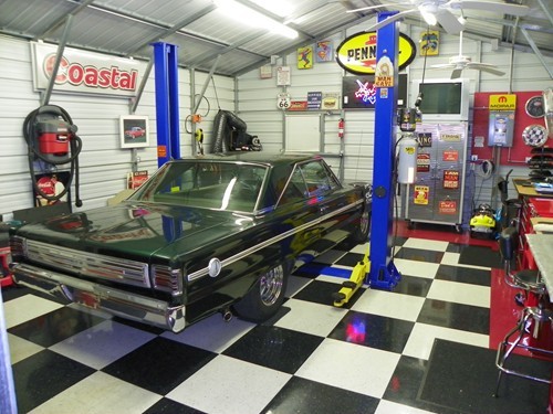

Thanks for the help guys. I probably will not get to it for a couple more days due to my work schedule. Here's a few photos of the Hemi Scoop. MMG

Hi Mopar,very nice car ,i like the floor in your garage ,What type of flooring is it,I dont have a hoist so can a floor jack be used on it
Thanks
Thanks
The floor is a VCT with a high gloss sealer. It's holding up very well after about 2 years of use. If you wanted to use a floor jack, I would use a piece of wood under it to protect the tile.
