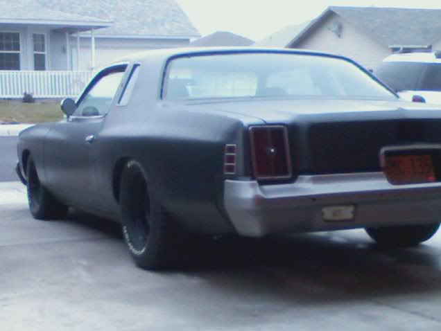

http://i831.photobucket.com/albums/zz238/chrybb/0211091703_00011.jpg These are 265/60 16s. 245/60 15s up front. Probably should've gone with 255s. 16x8 and 15x7 rims. Theres not much chance of finding a 17" tire with RWLs. Unless you don't mind a light truck tire, but that might look kinda funny. I once had 31" truck tires on the back of a C-body and they didn't look too weird. Well, yeah, it was pretty weird.
I managed to catch up with you at the Cordoba Club board ie: backspacing. Hope the info helps. Painted steelies make ANYTHING look tuff. Except Subaru Forresters. They just look like they had 4 flats in rapid succession. weird.
