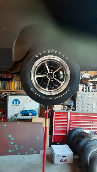

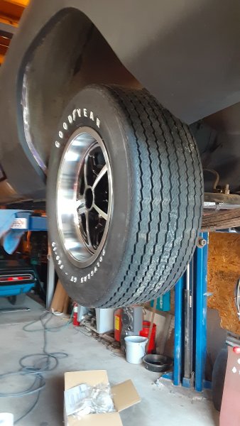

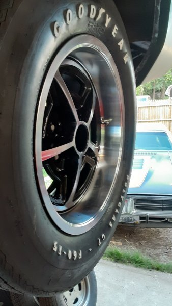

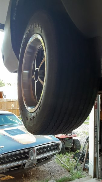

I ordered these wheels eight months ago, and the arrived today! They are Dynacorn's 15 x 7 Magnum 500 wheels. I was looking for a wheel that would appear like a stock 14 x 6 inch Magnum 500 wheel that would fit a 15 inch tire. These are the closest I could find.
The car I am building the replica of had 14 inch Magnum 500 wheels with Goodyear Polyglass tires. I have to order the center caps,but I think I achieved the look I wanted for the car.

I run the same wheels in 17X7. Make sure the wheels are seating properly against the brake drums or discs. I had an issue with mine hanging up on the swage on the wheel studs. The solution was to chamfer them a bit.

Thanks for the heads up on that I will check it out!
