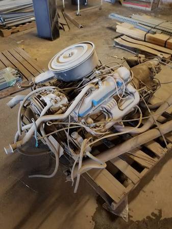

If it is not yet sold I will be bringing this home. 1975 motor home 440 with a trans. I spoke with the guy who pulled it and he said it was sitting for a very long time, he ran a temporary gas feed to the carb and it started with little difficulty. He drove it in to his shop to pull it from the motor home. The motor home had 54000 miles on the odo. And bias ply tires.
What can be done on the cheap to get this in to a car?

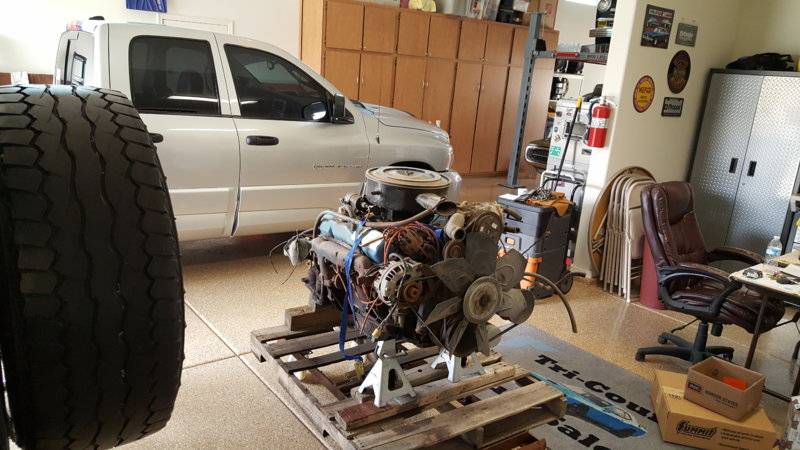

I am hoping the bottom end is fine. From there I would like to keep the budget for the engine in the $3000 range. Is that enough for aluminum heads and intake, cam and gear set, 3310 carb, maybe an oil pan and pick up, and headers? I am hoping to stay away from the machine shop.
My goal is to swap out the 300 HP 360 I have and switch to a 400+ hp/tq 87 octane, decent MPG, docile big block. In the car and driving for $5000? The swap will be expensive, radiator, accessory brackets, conversion mounts. Dont know if this doable in a $5000 all in budget?
