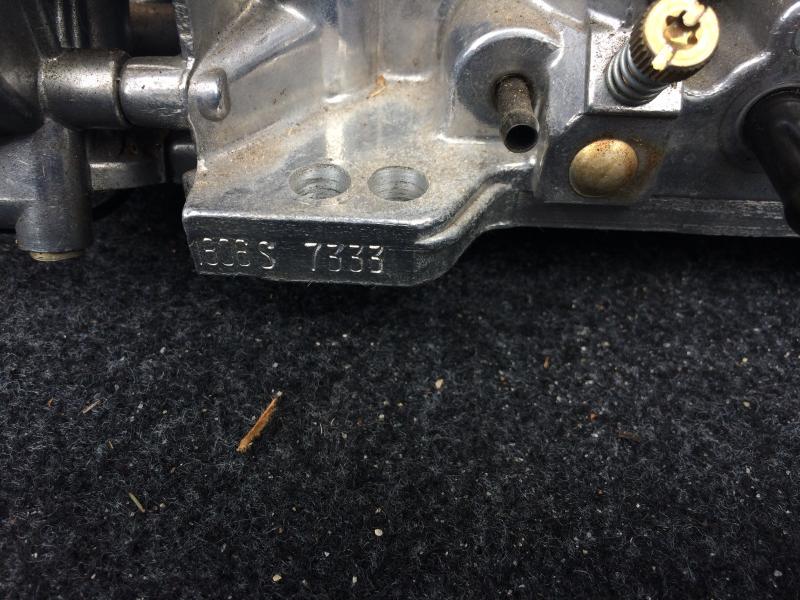

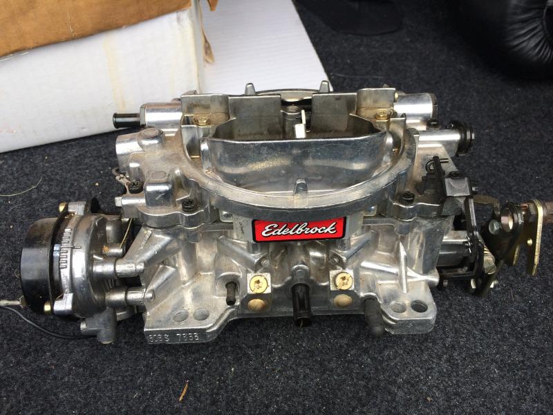

Ed, I was gonna send this carb out but I was doing a basic function check while whiping it down and something has happened to the secondary throttle shaft. I have two other carbs in pieces somewhere in my garage but as you know Im moving this week. If I can get something cobbled together and try it on my dart before I send it I will if not it was worth a shot.
Its also only a 650 and it was on a bone stock motor home 440 that was rebuilt and worked great in december 2013. I used the block and put the carb in the garage tucked away ( I use holleys). I dont think its worth your time its kinda funky now.
