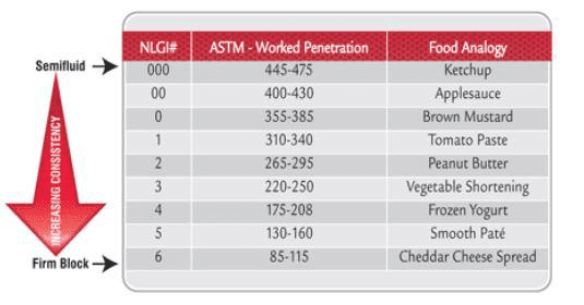

IMO.....ANY API (American Petroleum institute) NLGI (National Lubricating Grease Institute).
Traditionally, a grease's stiffness is indicated by its penetration value and is evaluated using the standardized National Lubricating Grease Institute (NLGI) grade chart. The NLGI number is a measure of the grease's consistency as indicated by its worked penetration value.
There are nine different NLGI “grades” including 000, 00, 0, 1, 2, 3, 4, 5 and 6. ... The correct NLGI grade is an important consideration because not all grease applications are the same. Some grease applications require softer grease so it can be pumped easily through small distribution lines and valves.
