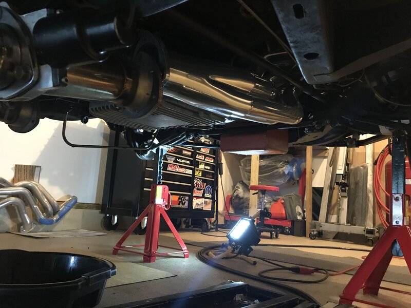

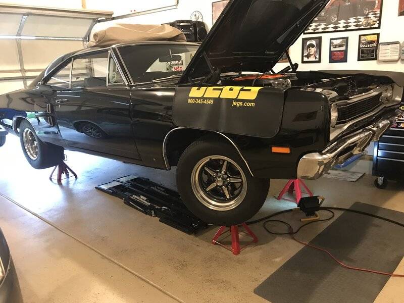

The Bee is up in the air, and dropping the trans/Gearvendor tonight. Though I still need to run out and buy another jack for tonight, one jack to support the motor, and one to lower the transmission. Also needed higher jack stands, so I searched the posts here, and picked up 2 sets of the US Jack 6-ton stands and being very close to Benton Harbor, MI, the jack stands were here in a day. As someone said in one of the posts, "how valuable is your life?" There's always a part of me that is hesitant getting under a car even with the wheels on.
Luckily I'm very close to Keith Long (727specialist.com) who will be doing THIS rebuild. After learning about the Griner valve body, I'm very interested to see if I notice any difference in the shifting.

View attachment 1174917 View attachment 1174918
I'm sure that set up is safe, but I'm like you in that I hate getting under cars when they are in the air.
I'd put a stack of hardwood blocks under the frame rails too, wherever I could that would still allow access. Just as extra insurance.
