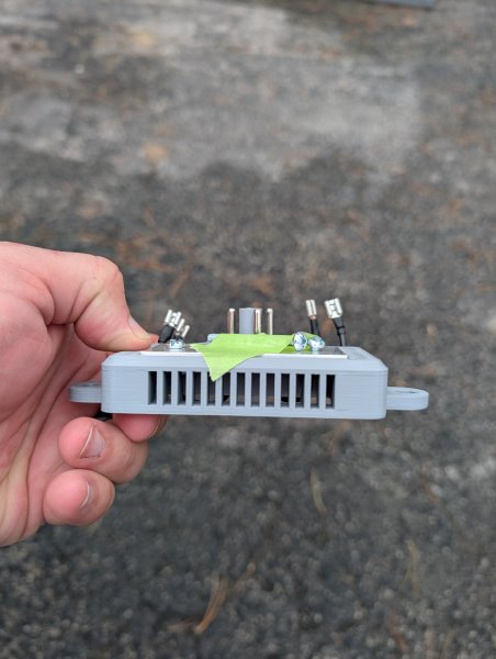

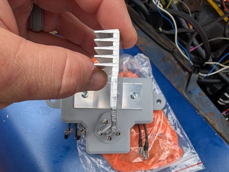

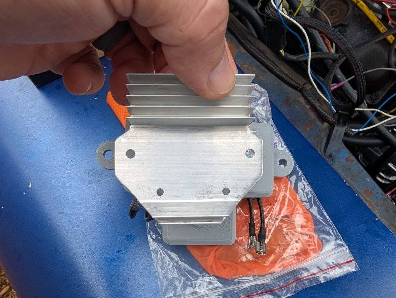

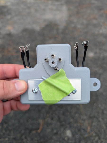

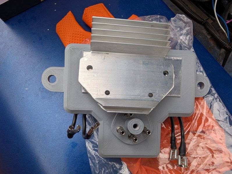

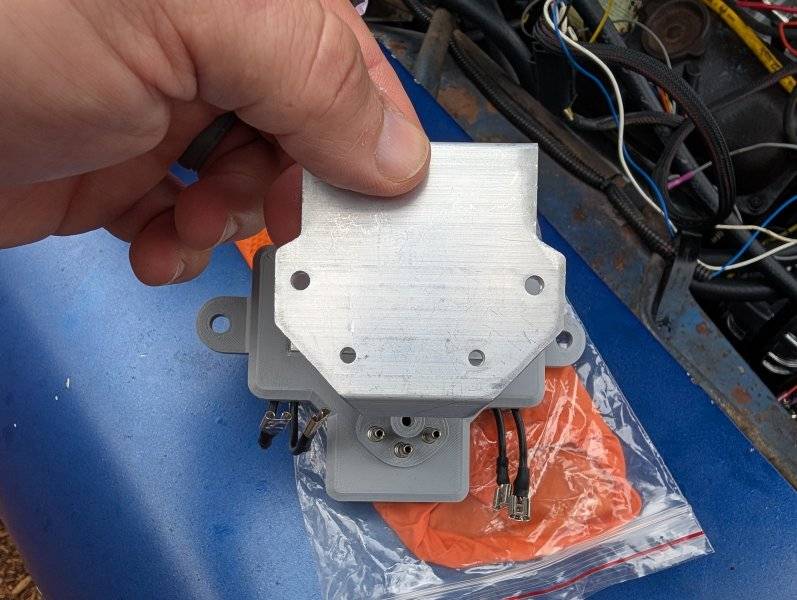

More photos of the 3d mount. Retains factory wiring plug. Bought this for when I replace my hacked up 50+ yr old harness.

As far as heat sinks, what I tend to use is when someone is disposing of an old desktop computer with the motherboard and old chip installed, the heat sink on them are robust and designed to protect the chip from extreme heat, good source for a cheap heat sink.
GM makes this:
Part 10474610
I'm going to trim the bottom edge down and add it to the 3d mount for extra cooling.

I was burning my fingers on the last one- probably a pretty good sign it was getting too hot mounted to the bottom of the distributor.
