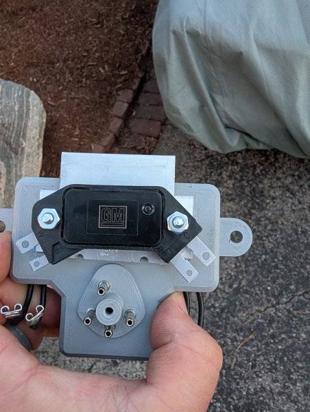

The paste goes between module and heatsink to transfer the heat better.
Look forward too see your modifications. I don't have any real world Temps from my car yet either ... but it would be interesting to see Temps before and after you add your additional heat sink!
I ended up cutting the bottom fins and two of the main fins to get it to fit. I have nothing to indicate that this is necessary, I just had already ordered the heat sink before I bought your 3d printed mount and figured the extra heat sink wouldn't hurt.
