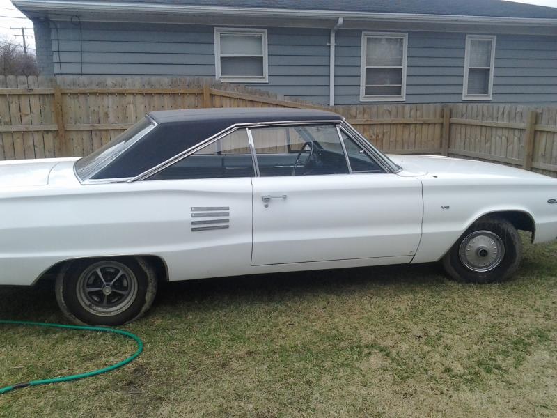

Ok well here I go, This is my baby, I got her for double the price of what it worth! IMG_20140414_181244.jpg

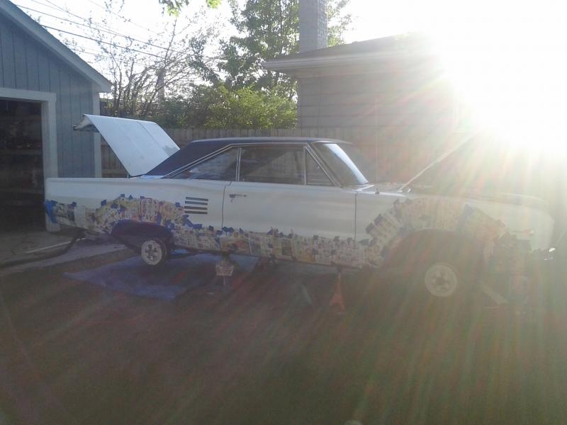

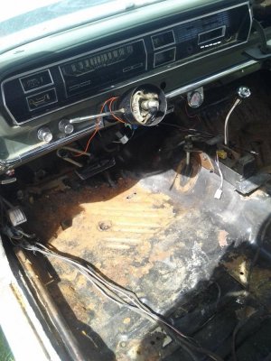

IMG_20140302_132321.jpg It has the old 318 Poly, has some bondo, holes, leaks, and the interior is BLOWN OUT!Needless to say my wife is not a fan, oh well nothing to do now but prove her wrong. When I first got the car I figured, "hell a few weeks and I'll be riding" I just got a notice today from the city that I can no longer keep the car on jack stands in my yard....M!#@!er
Once I got it home I did whan any professional auto rest-orator would do "DRINK 12 BEERS GET HER RUNNING AND STRIP OUT THE INSIDE YAAAHOOOOO!
The next morning I realized that my wife may have been rite, but I will go down with the ship before admitting it! It had holes in the floor, all the electrical was jacked, the car was originally green, what little I had of the inside was gold/green rot.newbies 010.jpg

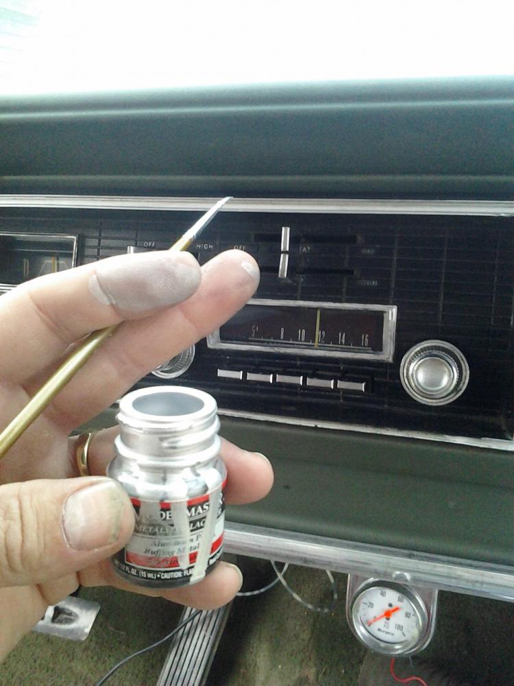

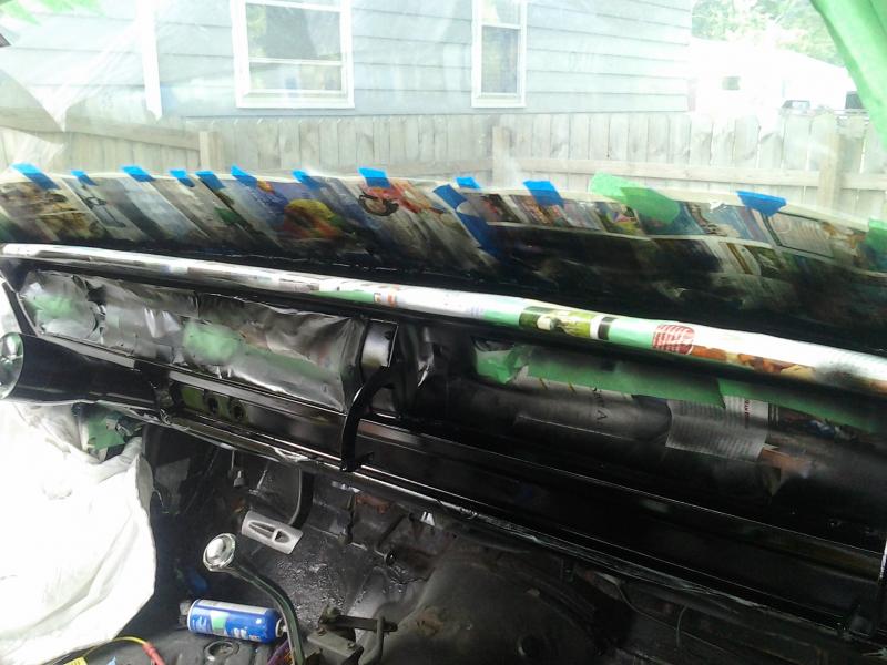

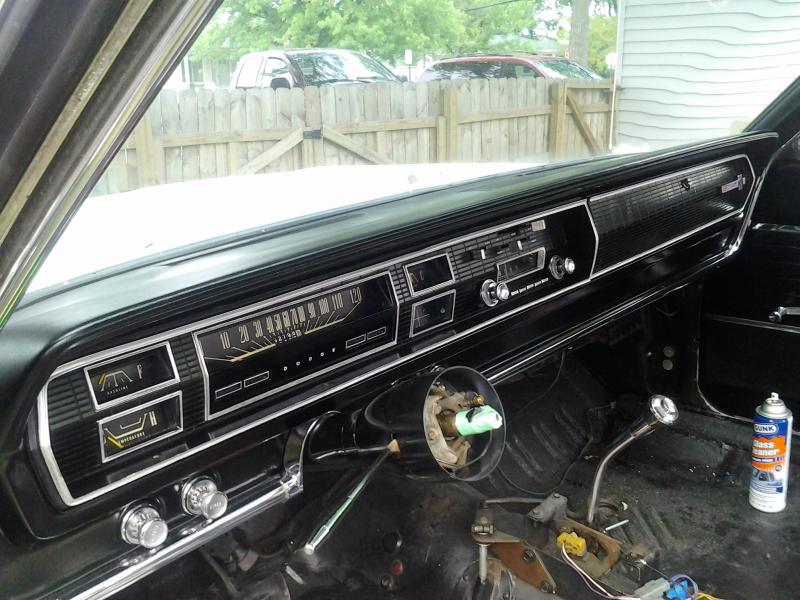

I painted the dash, doors,door panels you name it, I painted it, that Vinyl paint is the BOMB! I hand painted all the details on the dash.IMG_20140421_195142.jpgIMG_20140712_185225.jpgIMG_20140705_201247.jpgIMG_20140706_172327.jpgIMG_20140508_162039.jpg

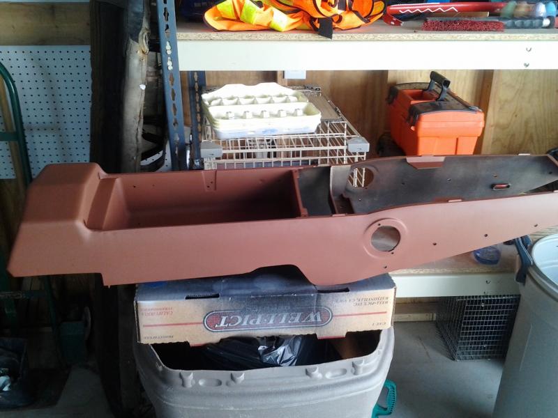

The console was a pain in the but, all them little lines, and that metal flake paint in the garage damn near killed me, do it outside kids!

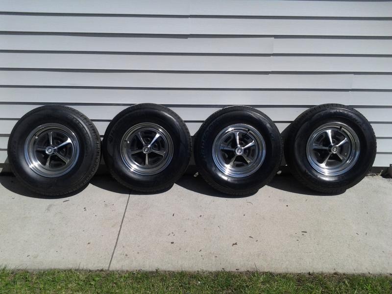

I had fun repainting the rally rims, I used a bed liner satin krinkle paint, "I love It!"IMG_20140511_153950.jpg

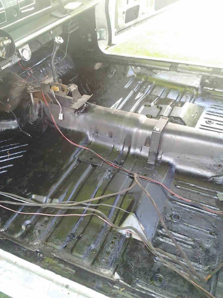

I then put the thing on blocks and undercoated it. This job is a pain! I used a black and decker gravity fed electric sprayer...messy, very messy...IMG_20140524_193240.jpg be sure to tape off car well, you ain't getting it off! And I also soaked all the seat belts in R.I.D Black dye.

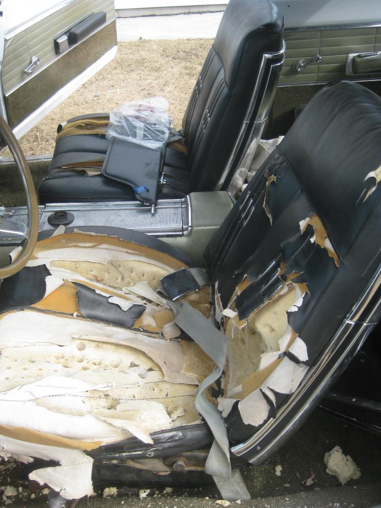

My personal opinion is that high backs will kill the 60's vibe of that car.
I've got seats from an 80's Dodge 400/600 convertible in mine and they look like they belong there.
They recline and have head rests, as well as a deeper bucket...
...but they look so much like the 66/67 seats, folks might not be able to tell.
...and you can still find them in junk yards if you look long enough.
Might not even need recovered....and they come in white.
