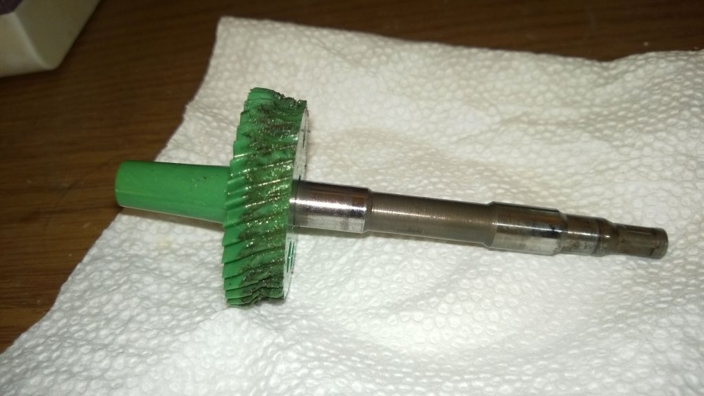

What I learned the former owner did wrong today:
I got the correct speedo gear from a fellow FBBO member and got under there today to swap it out for the wrong one in the tranny.
When I pulled out the old one, this is what I found:
Yeah, that rascal is chewed all to hell...
The FSM has specific instructions about "clocking" the adapter/housing a very specific way in order to properly pre-load the gear up in the tranny.
This is what happens when one doesn't do that.
I no doubt have tiny little pieces of green plastic floating around in the 4 speed now. Lovely.
