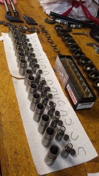

Before I installed these brand new lifters, I had to disassemble, clean and oil them as they were full of some sort of cleaning solvent. Been working fine since I installed them. Could have been disastrous
