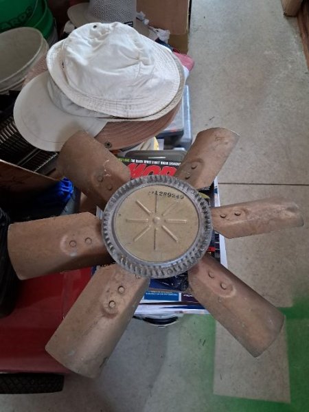

This fan measures 19-1/2" across from blade tip to blade tip. Would this fit into those re-pop 1962 (2) piece metal fan shrouds?
Also, what engine did this originally come on, if anyone knows?

19.5" is way to big for a b body shroud, 16" or 16.5" is more like it
Htt fan looks aftermarket. In 60's and 70's did factory Chrysler ever us a 6 blade clutch fan? Aren't they all 7 blade?
The clutch is aftermarket because of the slotted mounting holes, factory had round holes only.
THANKS for the info! I KNEW it looked really funky!
