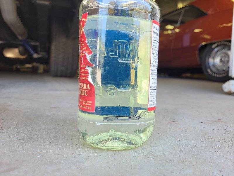

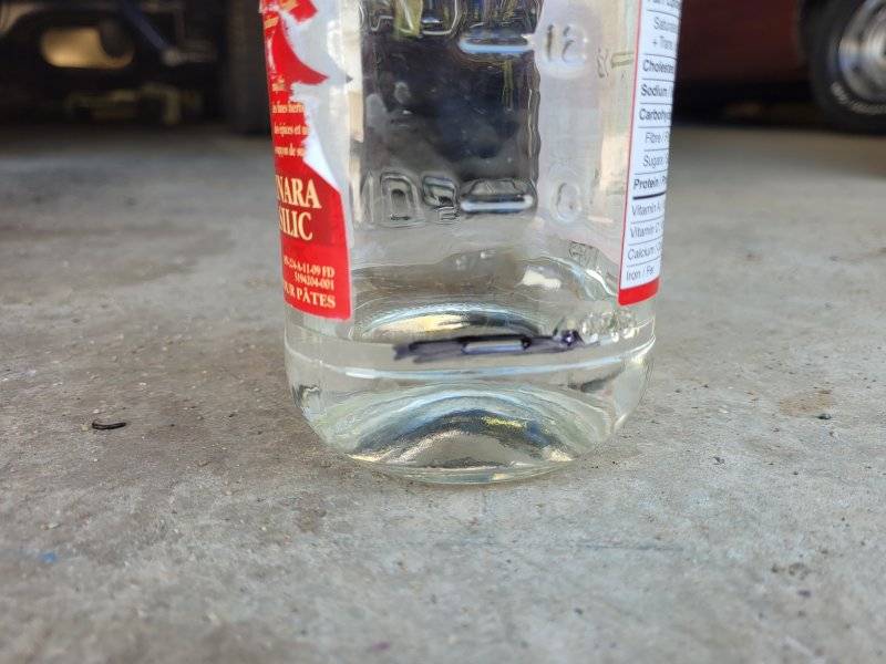

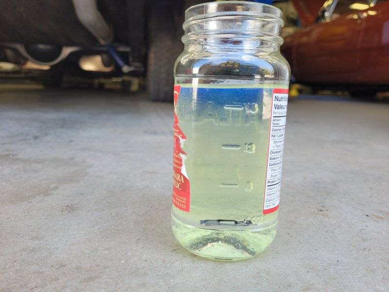

Pretty simple, take a mason jar with an inch of water in it, marked with a line, to the gas station. Turn on the pump and top the jar and let it sit for a bit. Does the "water" line move up?

Thought I'd better take my own advise after reading that all fuel in Canada must contain renewable product under the latest green energy bs. Like I said as simple as putting water in a jar and add the gas. Zero ethanol in my Midland CTC premium bought today. This takes less than a minute, you can do it at the pump..
