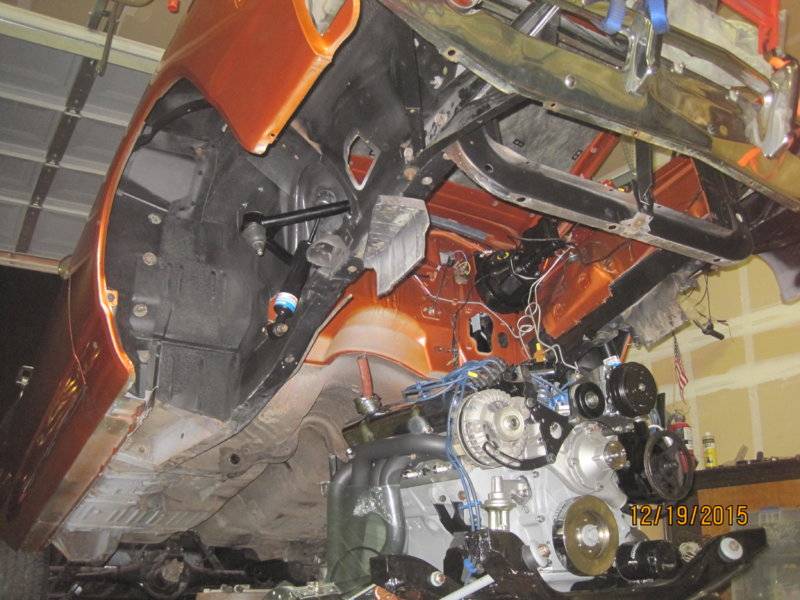

anyone lower the body down onto the complete engine and then attach k-member to body.
Yep. Dropped the Coronet using a cherry picker attached to the bumper brackets.
Dougs headers.
excellent , looks exactly what I want to do. thank you.
