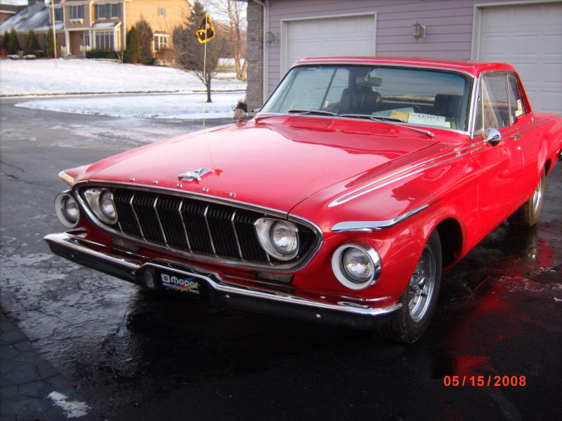

HiYa all, I bought a 62 Polara 500 that someone stuffed a 71-383 & a 727 into it just to "move it around". I'm looking for feed back on what you "62-65" guys are using for intakes/engines & transmissions now a days. Whats the best, reasonable, cost effective set up to improve this car? Probally would like a street/strip setup. I have been "out of the loop" on the 62-65 world for quite a while. 062.jpg Are the stock early ball & trunion trans worth re-building? Thanks for any input and comments! MoPar to ya!
That is a GREAT looking Polara. I have a 63 Sport Fury that is probably about equal to your Polara in condition, but looks so plain jane in the original tan exterior color. My car has the original 383 and 727 pushbutton it was built with. I have a small crack in the block, so I purchased a late 62 date coded 383 and will rebuild it to replace the original eng. I'm going to store the orig 383 and eventually fix and rebuild it. I finally decided to keep the car as original as possible. Most of the people I have talked to have used a built 440, exspecially for street/strip use--with a hot cam and blueprinting you could hit 450 to 500 hp fairly easy. I don't know what people are doing transmission wise. I am going to stick with my orig 727. Good Luck--post more pictures of your car when you can

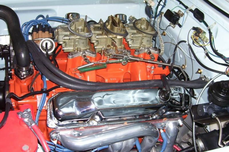

Car: 1963 Polara soon to be a Maxie Clone
Engine:
1972 "440" bored, stroked.
Heads: 452s worked by Jerry Goodale, SMS, (Specialty Motor Service) Riverside CA
CAM: It's radical
Intake: A&A Trans "Max Wedge" Cross Ram
Carbs: Twin Edelbrock 600 CFM
Headers: TTI
Trans: 1965 727 "Push-Button" supplied by Bob Mazolinni Racing, Riverside CA

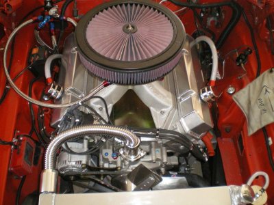

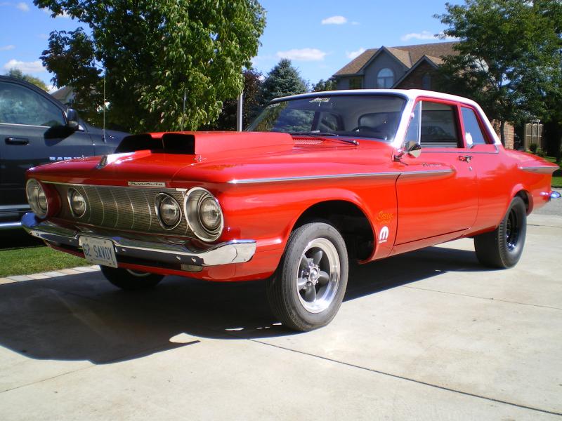

World aluminium 440 block stroked to 572 and a well buld 727
Curious if you have ever raced your 62 yet at the track ? Is that Victor heads on it ? Wondering what kind of power it is making and how fast at 572 cubes !! Ron
