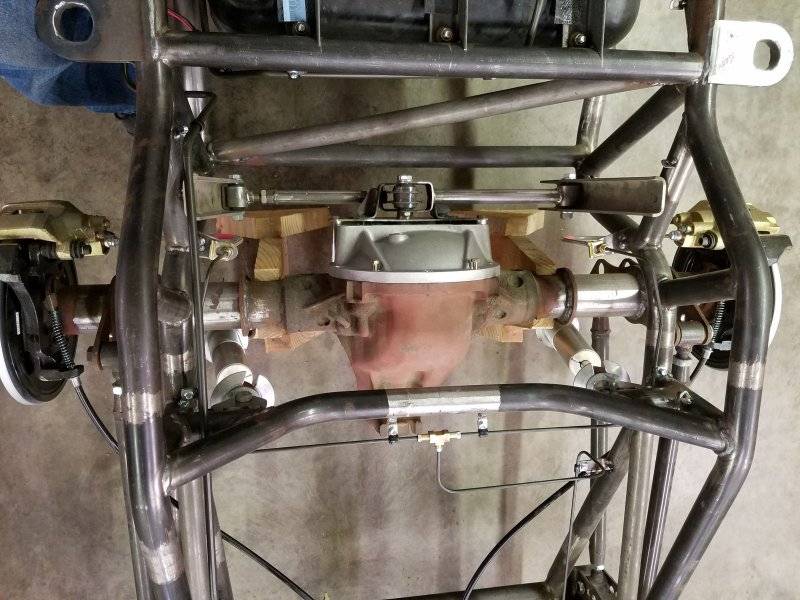

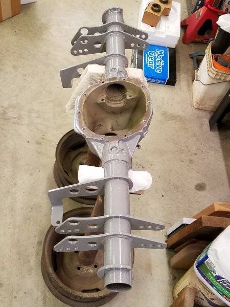

Mine is out of an 1985 Dodge
Diplomat police cruiser. It has a
sure grip, and has been shortened
3" per side to fit a custom tube
chassis.

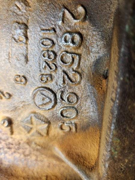

anyone good at date coding?

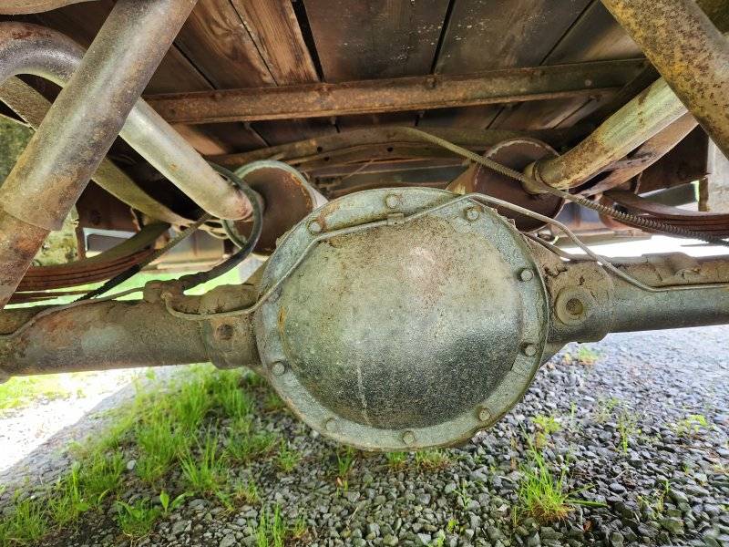

Here is the suspect weak link in my ratty truck. Identified as an 8.25 with a 3.21 gear which may be getting replaced with a Durango SG rear.
