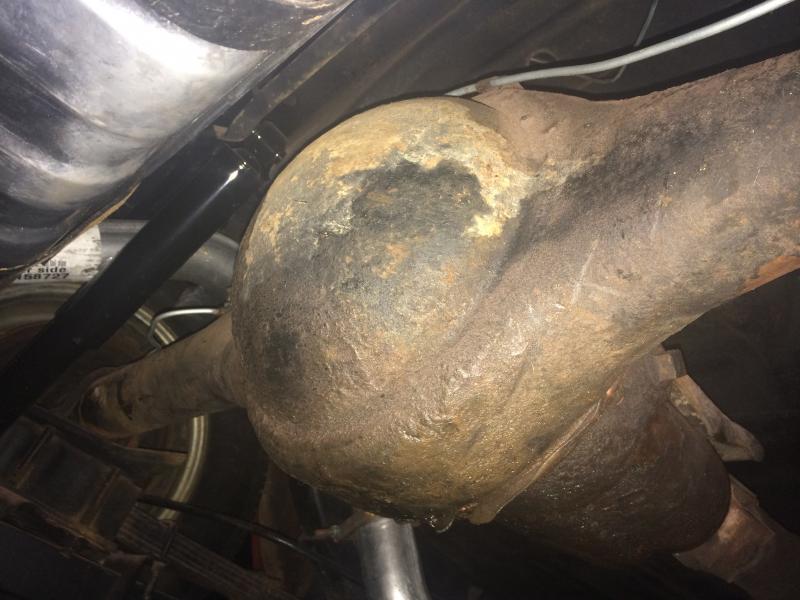

So I have been reading and reading. And it has been hard to grasp exactly what it is my car has and what it is I can do with it.
I own a 1973 Plymouth Road Runner. And to my knowledge this is the original rear axle.
I have seen the graphic that shows the Rear End housings from the rear view and identifies them...
From that graphic it looks as though I have an 8 3/4 housing?
Currently the car has the One Wheel Peel.
Am I able to swap out the Gears inside the housing and make this a Posi Rear End which leaving the axle in the car?
OR
Do I need a whole new Posi Rear End Axle setup?
you need gears of your choice and a posi unit
Yep that's an 8 3/4, what you need is a sure grip carrier (it's what the actual gears are bolted to). You can use the same gears and housing and everything you have, but it's easier to buy the center section w/ the sure grip already in it

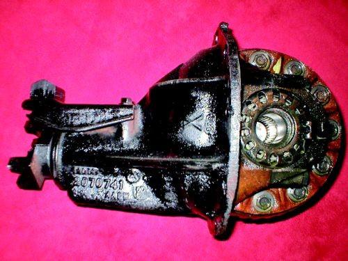

in your first picture, on the other side you'll see some numbers, last 3 digits will tell you what case you have
This one's a 741

the picture I posted of the 741 carrier? That's a pumpkin - the part of the 8 3/4 rear end that unbolts and comes out the front.
If you find another case that is a sure grip, but it's not the same case number? No problem! just swap out the existing center section for the sure grip one. Pull both axles, the drive shaft, 10 bolts and you're in.

Just an observation...on your rear axle...seen fairly good cases of corrosion, but...
Almost looks like right out of the swamp. But, who knows, a little sand-blasting here and there.
8 3/4" rears are plenty. Just have to look. Easy to find another in much better shape...maybe even with gears and such like you want.

Thanks Miller, I appreciate the observation. It is pretty dirty and in rough shape.
If mechanically it works, then I will keep it this season. Swap it out next year after I finish off paying for the rebuild.
