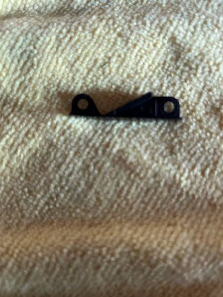

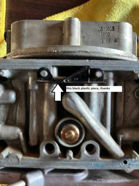

Here in the pics is a part from the 4670 middle carb. what is it? Do you need it?
I have all docs for the carbs and can't find any info on the part.
Thanks in advance.
it is a fuel slosh baffle. not super critical but it keeps the fuel from sloshing out the vent
Vent Baffle Fits Holley 4 and 2 bbl got it thanks a bunch.
