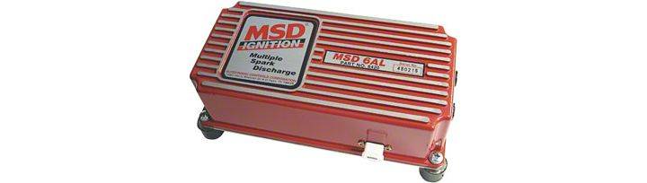

I have a couple msd distributors in use with analog 6al boxes. I avoid the digital boxes, way too many complaints about reliability.
