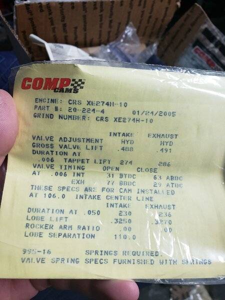

so i have this cam i want to put in my 360... is there another spring i can run other than the comp double springs(995-16).. i already have new seals and would want to have to buy Viton seals just to run the double springs... cam is comp CL20-224-4.
XE274H-10
@50 230/236
intake .488 exhaust .491
lobe sep 110
I am not sure but there has to be. I run edelbrock springs on my big block and they are good for .600 lift and single spring configuration. That cam doesn't seem to wild at all. I run the comp XE268H with the stock springs that came on indy cylinder heads INDY X heads on my 360 with no issues. They claim those springs are good for .525" lift.

I agree with PRHeads, you need to determine what installed height you have with the retainers & locks you have. Use whatever seals fit. Call Comp or an experienced builder for a single spring recommendation.
Generally I'd go with the cam manufacturers recommended spring.
