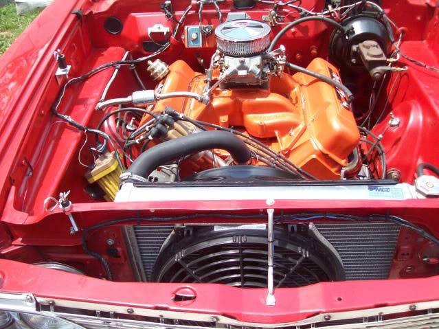

I put a jeggs direct fit radiator in my 70 coronet. Electric puller fan with thermo switch.

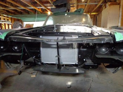

I might have to get something made. I am trying to avoid it. I guess I will buy something that should fit from a measurement standpoint and go from there. I have an intercooler and ac condenser to mess with.

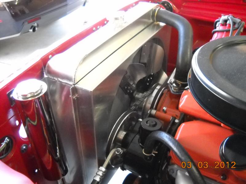

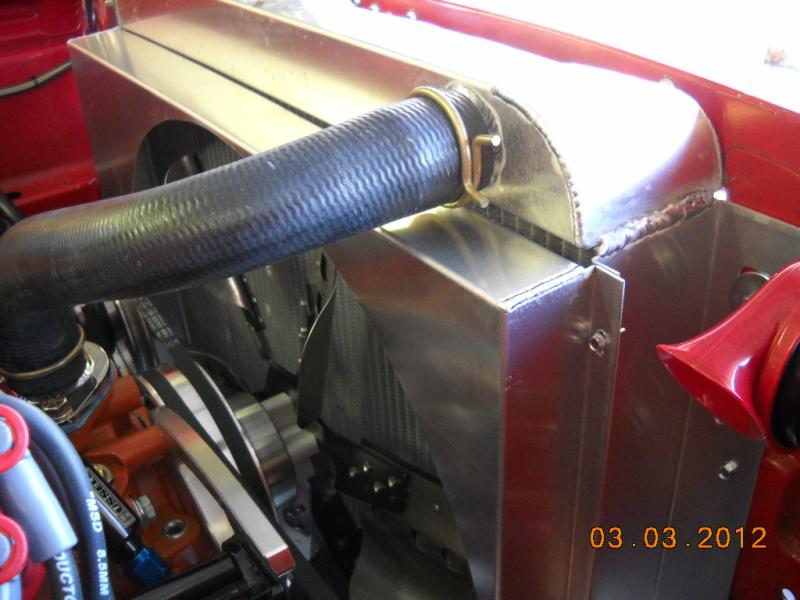

This is an AFCO rad I bought from Mancini for about $329 I do believe. I forgot the size but I just told Mancini I wanted the AFCO rad that fit my 63 Sport Fury. It comes with brackets but no holes. I just sat it in and marked the holes and drilled them. Works great for me. The shroud is from a Dakota that I modified to fit. I also have an electric push fan on the outer side of the rad in case I get stuck real long in traffic and it creeps up to 200 then I can turn it on as it is on a toggle switch. Ron
Here you can see the electric fan I added. Ron

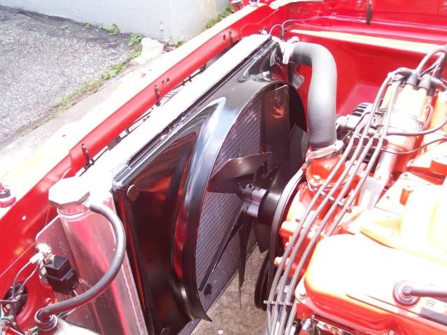

I also got my set-up from Mancini, but not a cross flow. Aluminum 22" core, made to order shroud and a fixed 17" fan. Filled out their custom order sheet and it fit like a glove. Not the greatest pictures. Hadn't hooked up the overflow tank yet.
Dave that is one nice setup. Did you buy the shroud from Mancini also ? And do you mind me asking what it cost ? Thanks , Ron

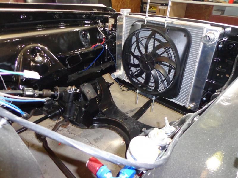

In my 64 Polara. PRW industries 19X26 aluminum rad. Cant remember who makes the electric fan. LOL
Ninja...isn't that fan a tad small for your radiator?
Found out. Its a Maradyne Mach series.
225w sealed motor. 2160CFM with an adjustable temp. switch.
Hey Ron,
Yes, both the radiator and shroud came from Mancini. Purchased in Feb. 2012. Radiator was $499. and shroud was $139. I tried working with Ron Davis, Be Cool, Wizard and a couple of others but found that Mancini was the easiest and most interested in "getting it right". I dealt with a fella named Dean.
That looks fantastic. I also like buying from Mancini. Got to support our Mopar specialty guys.
