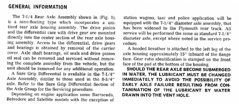

I was looking for that and couldn't find it.
That might be when the late 10 bolt version came in.
That is what they called it but didn't have a year listed.
