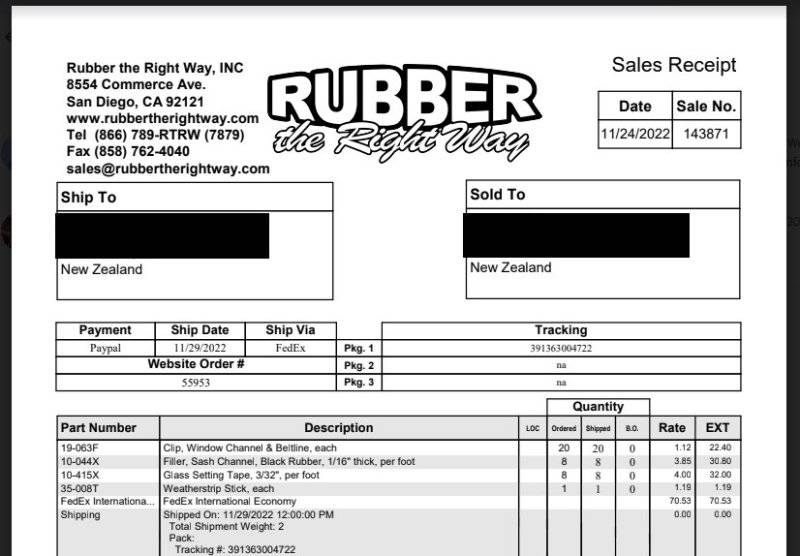

I did my A100 recently and used tape from "Rubber the Right Way"
1/16" tape is the one I used.
I bought the 3/32" also as I wasn't sure which would work best. For the small cost of a bit more tape compared to shipping price, it was worth my while taking a hit on the tape.
