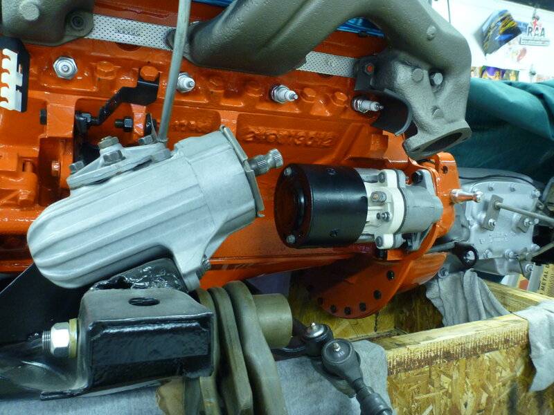

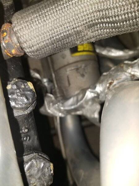

Looking for recommendations, I think this one died prematurely IMHO, so keen on alternatives if they are reliable performers... Here are pics

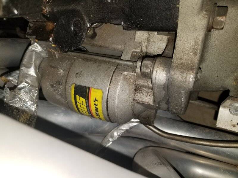

I've used 3 of these starters and have been impressed

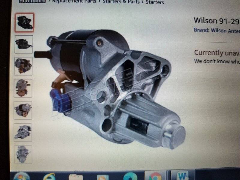

Ok I've found the BBB N17466 starter locally. Now to find the heat shield, without wrapping the headers is there a basic heat shield solution for the starter that is effective? Could really use guidance on this one, hoping there's a generic sleeve of some sort I can pick up

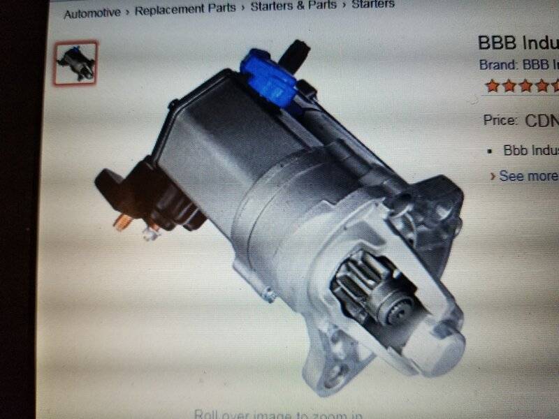

This is the starter that matches the BBB N17466, which appears to be Napa p#2446415. These pictures are off two different websites, showing the front and back of the part. Fits 91-95 Dodge Dakota 5.2L. Does this appear to be the correct part to fit my 400 ci?
