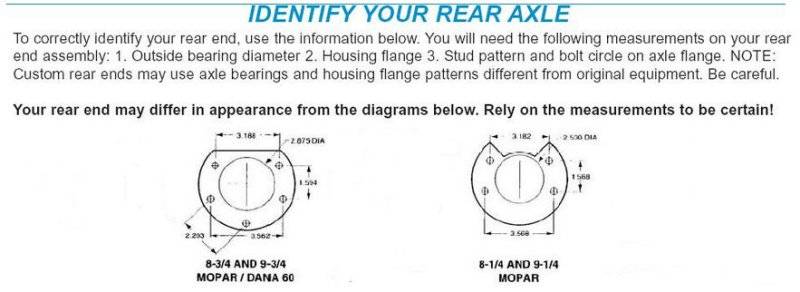

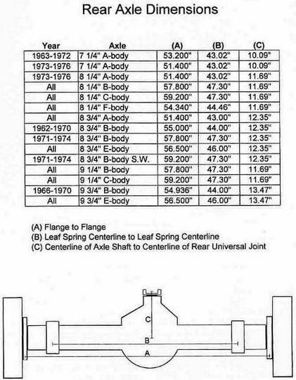

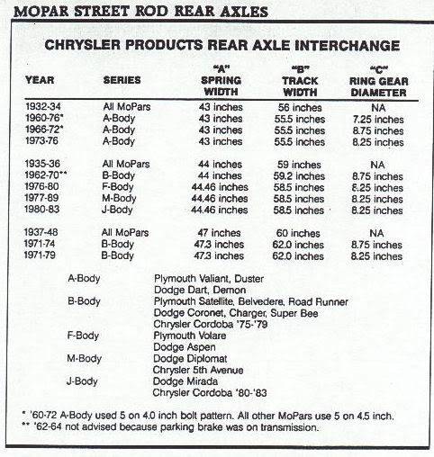

I have a sure grip with the # 2070684 stamped on the ring gear' it has 2.76 stamped also. That's all I have! Can anyone tell me if this is a 7 1/4,8 3/4 , 9 1/4 or 9 3/4 sure grip? Or what do I need to look for to identify it?
google mopar rear ends count the bolts,look at the pictures

u can identify the rear end by looking @ the dif cover if it has none then its a 8 3/4 the gears r="roll out he frount . if u have that style then it is more likly the clutch those r rebuildable the small 7 1/4 bigger 8 1/4 , the 9 1/4 r a cone type they r not rebuildable u replace the unit send me a pic of the rear end

Not trying to be a smartass here, I love you guys...but they're measured from the outside diameter of the ring gear.
this should help but on all mine the diameter was stamped on the ring gear . i had a 8.25(8 1/4) it was a 10 bolt rear end cover , byr i also had a 87 d-150 it had 10 bolt cover too but it was a 8 3/8 ring gear both had the cone type of sure grip &S both wore out & was not bebuildable shout of re placeing the unlt . u r bettr off with a 8 3/4 "banjo " type u can buy clutch kits for them or buy te from doctordiff DoctorDiff Drivetrain Components
