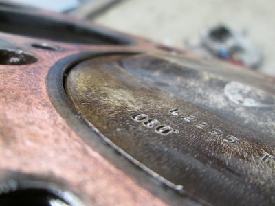

Does anyone know how long the TRW L2295's have been around? I thought this might give me an indication of how old this engine build is but have been unable to find any details. Thanks

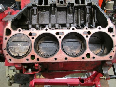

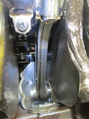

Thank you for the input. Why do they state the compression differently from Sealed Power? "Comp Ratio: 11.34:1 w/78.5cc Heads, 10.34:1 w/88cc Heads
They do appear to be just below the deck height as you state.

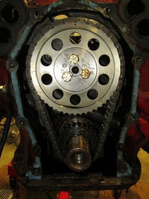

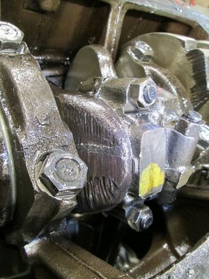

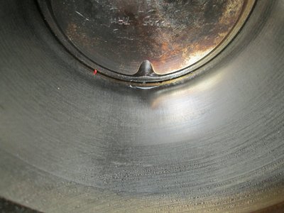

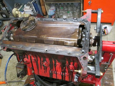

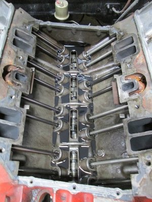

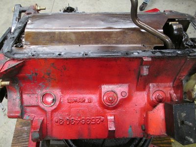

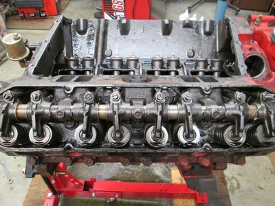

OK guys, please speak up about anything you see in the pics. The bottom end looks to be in great shape other than the oil didn't appear to be changed in those 20-30 years.
