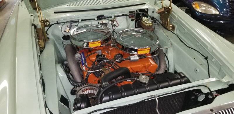

Mine is one of the most drivable cars I own, even with the Racer Brown 509 cam and push button transmission. Throttle response and drivability are excellent. The most power improvement was in the Max Wedge exhaust manifolds, but it is in the total combination.
