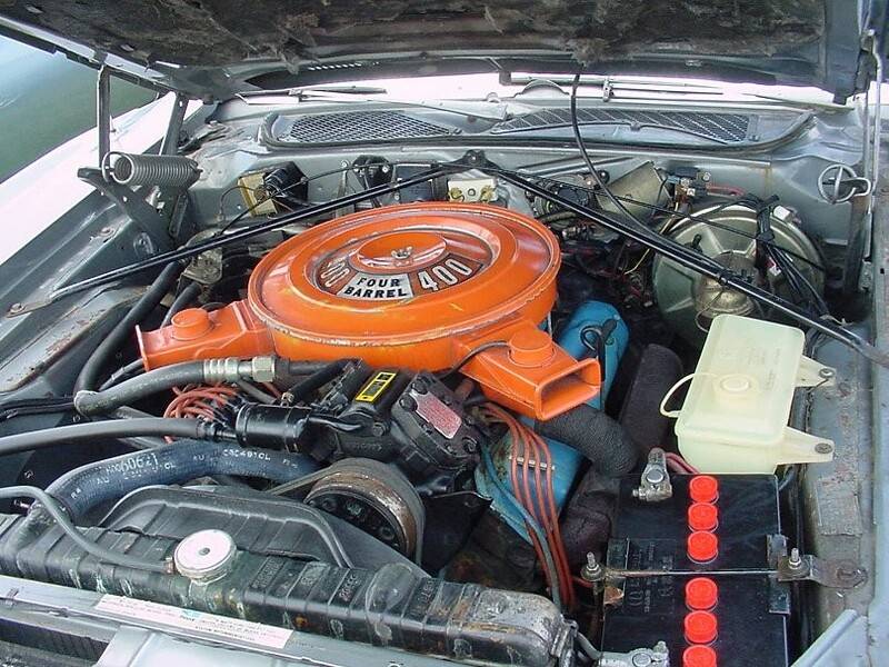

The one on my 73 is orange, dual snorkle, says 400 4 barrel
Car?

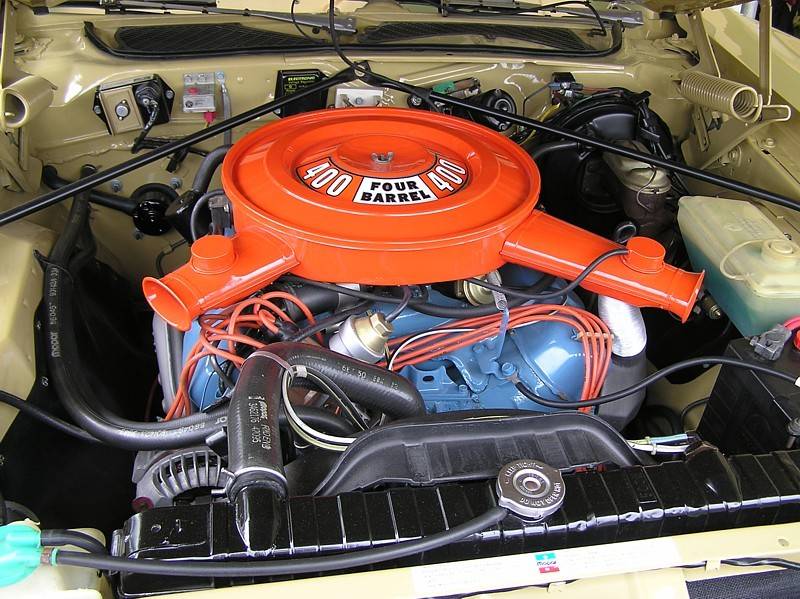

If it’s a hi-po application dadsbee’ s picture is correct. In 74 the inlets are more oval shaped.
Orange all the way for 4 bbl engines.
From Nick's Garage website:
Awesome, thanks, so the short square inlets were for 73s and the long, more rounder inlets were for the 74s? I think either will work for me...now that I know what I m looking for, will see what prices eBay is offering....thanks...
