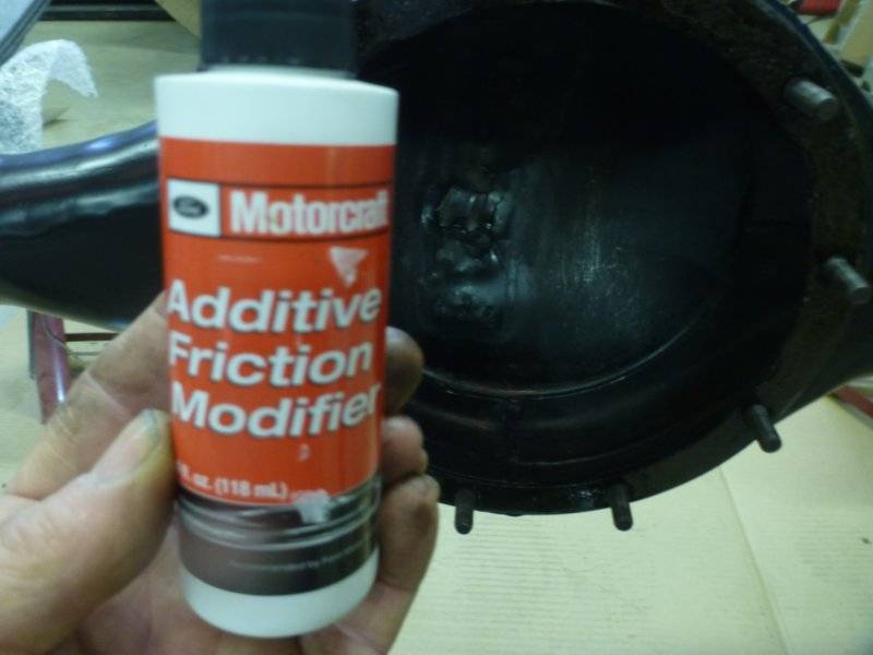

Open or SureGrip? If it's a Suregrip you need a bottle of Stinky **** added in. Do not use synthetic oil in a Suregrip...

This is about the fifth time I've posted this.
