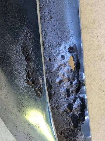

Guys, got my bumpers ready for the rechromer and need to patch a hole in the thinner bumper guard. Do I get welded up or does it need to be brazed up with a brass rod. Should I leave it to the rechrome folks or get done before taking it in. I assume either way repaired the chromers will be able to smooth out and rechrome. What is best way...thanks..
I would MIG or TIG weld it. I'm not sure how hot the tanks are, but if you braze, that part will have a different expansion rate at least. If it is all steel, then it's just a matter of straight and polish.

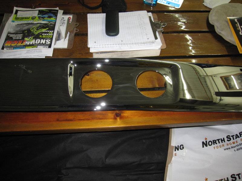

When I had my 65 Belvedere front done the chrome shop insisted on doing the welding. I did cut out the center (license plate opening) and tack in a plate with holes for my driving lamps, making sure the filler was perfectly flush with the original surface. Turned out great. Mike
Well, my plating company is two hours away and they are merging with another plating company four hours from them. Seems the plating chemicals are toxic to discard and folks are having to leave the bigger cities. I talked with a welder today who said he could mig it. I m thinking to let him go ahead and then send word to the platers to fix it if they don t like it and can repair it . Not going to be a show car but would like to save it if possible....thanks.
