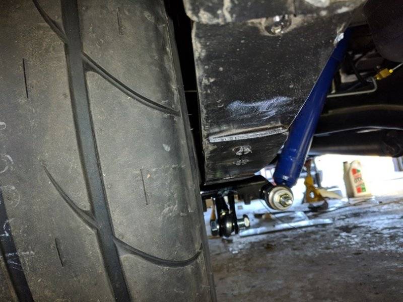

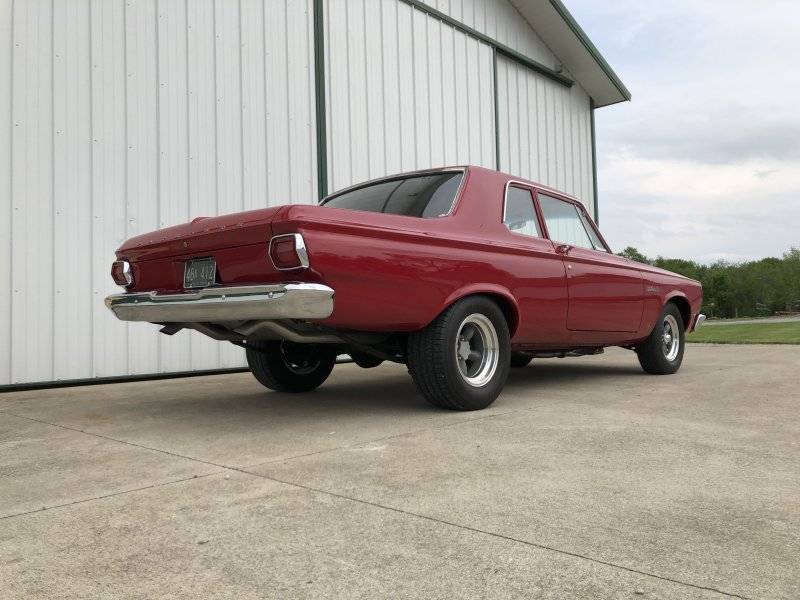

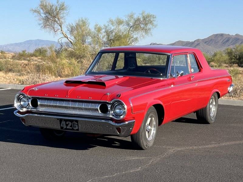

mine are 30x10.5 which is like 295/75/15 something like that.. on your car. i wouldn't touch it... perfect cruiser as is.. my car will get reverted to that one day, i already know :) Oh.. rims are 8" with 4.5BS and i moved the front of my springs in about 3/8"

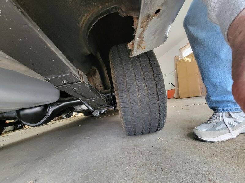

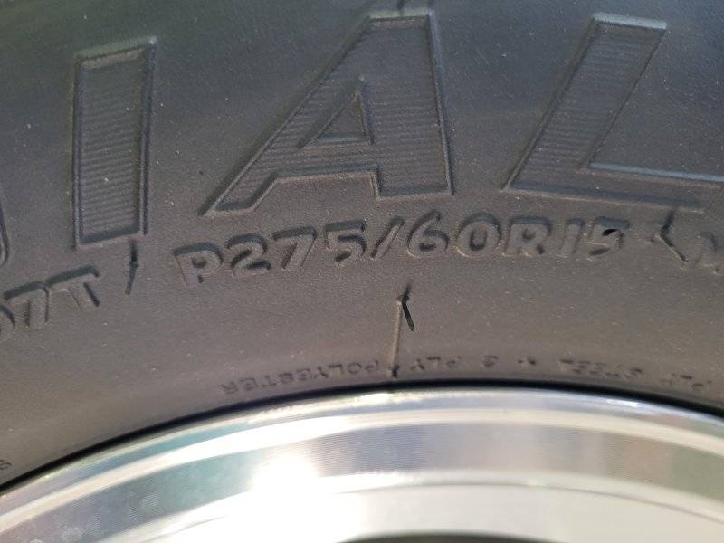

My '62 with 275 60 15. 8" rims. The tire measures 10.5" across.
