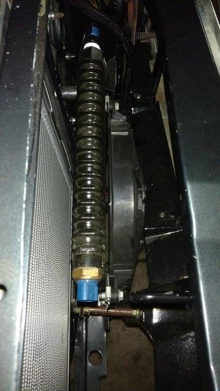

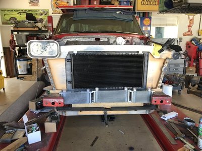

You can't go wrong getting one rated for an RV application. Your final size may be limited to what you can fit in the available area. Here is a shot of my layout. One each for engine[ big one], trans[ medium] and p/s[ small one].

Well you can make the same mistakes as many before you and mount one in front of the rad ( so you have warm air blowing on the partially blocked rad), or you can leave your lines connected to the bottom of the rad to make sure your tranny fluid reaches 195 degrees ( don't see the logic in that) or you can endeavor to accomplish exactly what you're trying to do - cool the tranny fluid. You might mount a narrow but longer heat exchanger horizontal, just below and behind the rad, but in front of the stabilizer bar, or forward of the rad in a horizontal ( or slightly tilted) if space permits. My cooler is out of a 2007 F250 pickup ( $45 bucks at the auto recyclers) and about 5" by 18" long, installed at a slight tilt in front of the rad with a pair of Spal 4 1/2, 2.5 amp fans mounted on the upper side. It's a "stacked plate" style cooler. If this unit can cool a tranny in a 2 1/2 ton work truck rated at 2 tons load capacity and 28,000 pounds towing capacity it certainly won't have a problem with my 600 hp 727.

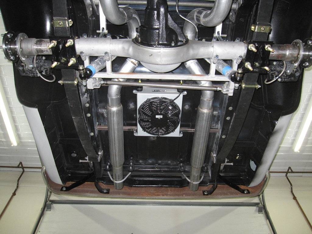

I used this fan cooled heat exchanger from Derale
. Fan is controlled by a inline thermostat.
Mike
I used this fan cooled heat exchanger from DeraleView attachment 516326 . Fan is controlled by a inline thermostat.
Mike
