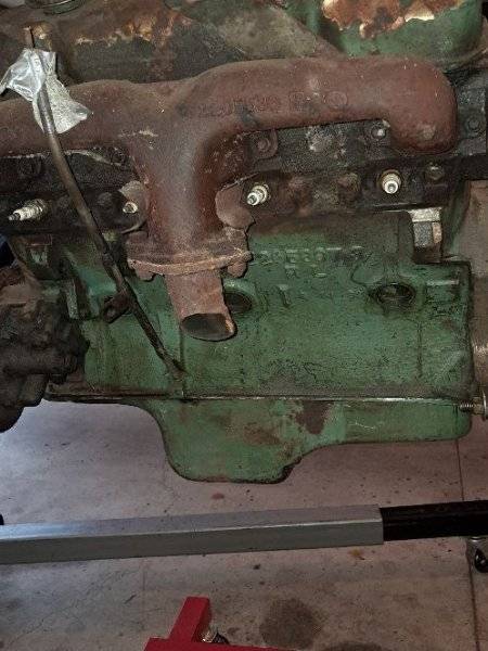

I currently have my 413 on an engine stand still complete before I do a top end rebuild. I am NOT going to hot tank the block. What is a good method to clean the water jackets?
