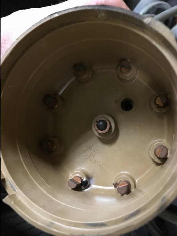

I pulled the distributor cap off and found this inside. There is a burn mark on one of the contacts. Actually melted it some.
Would this cause a loud buzzing noise? And why is it arching to begin with?
