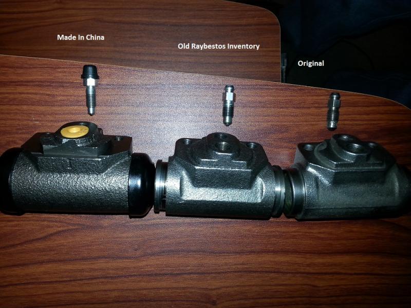

So, it would seem that all the aftermarket brands of rear wheel cylinders for 73 with 11 inch drums have under size bleeder valves. Originals were 5/16, but after market are 1/4 and they also have an extremely long tap into the cylinder. Unfortunately I couldn't rebuild my originals as they had too much pitting due to corrosion.

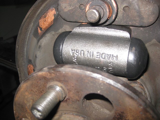

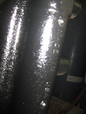

Glad you found them. After 2 or 3 defective parts from Rock Auto, I finally realized the local NAPA had some nice aftermarket pieces with a big MADE IN USA cast right into the body. Wrong size bleeder but that wasn't a consideration for me.

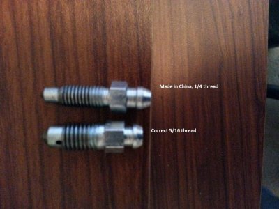

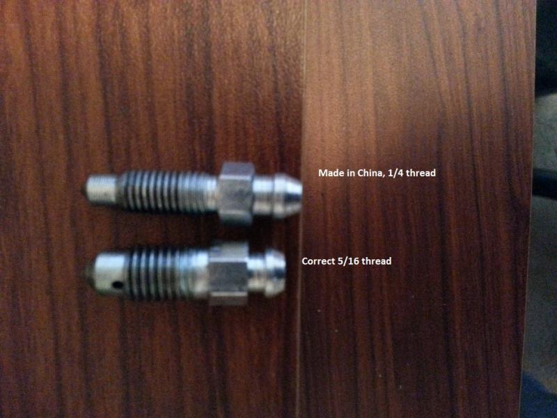

So, with the wheel cylinders I currently have, a couple of things, and this may not matter to most folks, but the bleeder shaft is 1/4 diameter, originals are supposed to be 5/16, and the bleeder is much longer then the original or correct OEM replacement at 1.25inches, should be 1.0 inch length. It also has odd size head, 9/64. Now, most standard wrench sets don't have that size so it makes it more difficult when bleeding as you have to open close by hand instead of using a wrench to open close, and may not fully seat when closing by hand. This is a also a problem when using speed bleeders as they don't fit because the cylinder has this odd size bleeder.
Aside from that, I read through a lot of comments from people that have purchased the ones currently on my car and on various sites, people have reported an issue due to the design of the thread and shaft length that these can actually pull air in around the threads when bleeding, and I believe I have seen this problem when bleeding as I have seen very tiny bubbles in my bleeder hose and this leads to never being able to completely get the air out of the cylinder.
I guess this is a symptom of stuff being made in China, as most of the aftermarket replacements are made there, so in my hunt, I found the Bendix site, and they have ones with the correct OEM bleeder size etc. So I will give these a try and see how it goes!

I hate to burst your bubble, but I have checked 5 brands, including Bendix, Wagner, and Raybestos, and all are made in China. You could literally take them all out of the boxes and put them in a pile, and there would be no way to tell which ones came from what box. I do however have a couple of people checking some other sources that still may have the older Raybestos stock. I'm on a mission now to find the right ones!
Like i said earlier, NAPA's premium brand came with MADE IN USA cast into the body.
This unfortunately is no longer the case, NAPA website shows the made in USA casting, but in reality, went to NAPA this morning, and they have the same Made in China stuff as do all the other places I have looked.
If you find a set that is still made here with the casting let me know.
I guess their stock varies, because i only did mine about 8 or 9 months ago. Call the one in South Plainfield, NJ, thats where i hunted mine down. It's a regional distrobution center. Maybe they'll ship one to ya. The guys there are good too, just ask them to check the casting and i bet they will.

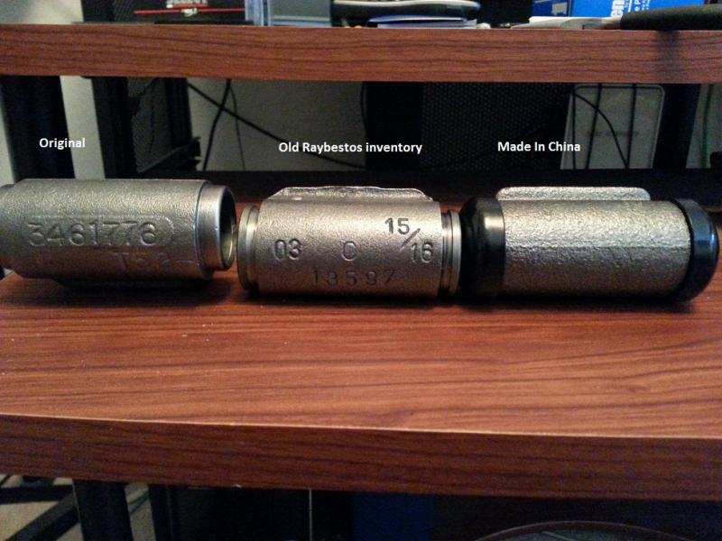

Well, I managed to find a set that are correct, actually John at Mopar Madness had a set from old inventory from Raybestos with the correct bleeders. I installed them today, and have gained a lot of firmness in the pedal, but still need to adjust the shoes on the drums, and I think all will be good. Anyway, here are some pictures of what the originals, Raybestos, and the cheap China ones look like in case if anyone is interested.
