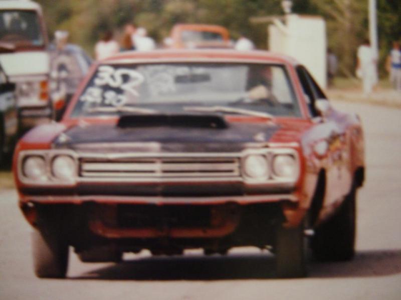

The only pic I have of the car with the 295's on it.... wish it was from the rear...

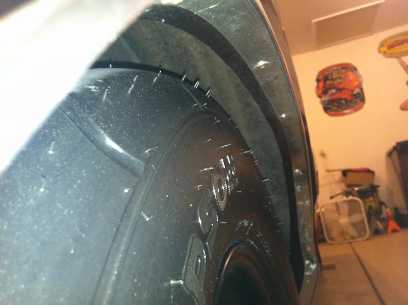

Make sure you check the clearance to the inner wheelwells also. When ordering custom backspace wheels for my Charger, I was worried about the springs and fender lip. Turns out I have more room to my springs than the inner wheelwell and ended up using spacers to clear.

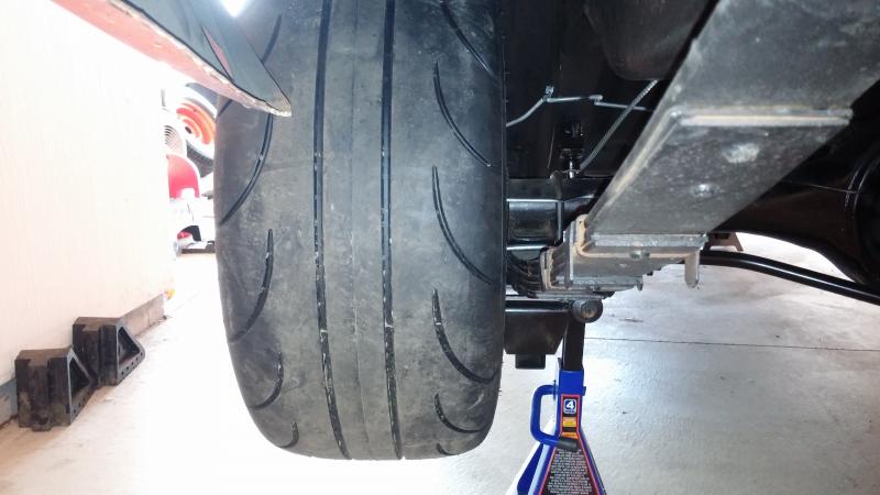

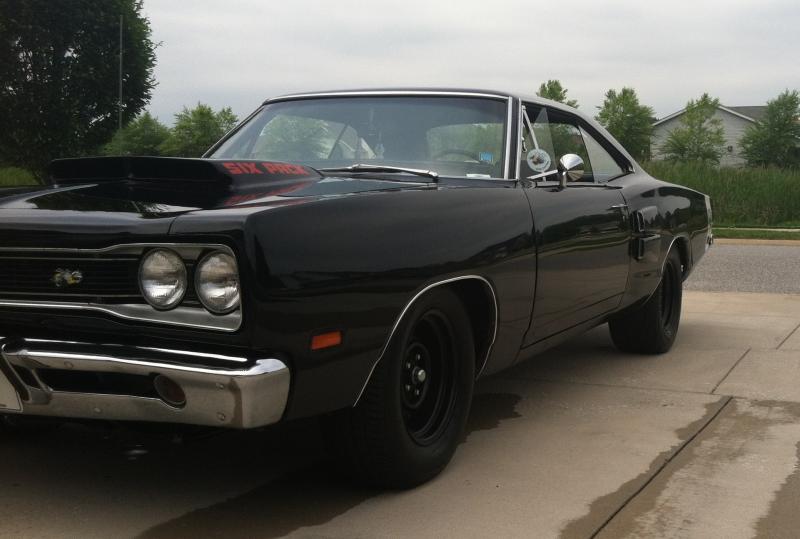

For my '69 Super Bee, I just installed a 15x10 steel wheel with 5.5" back spacing along with the MT ET Street Radial 295/55-15 this past weekend. Fits perfectly. Will post a photo later tonight.
Here's the wheel/tires tucked in my fenders
Thanks Lee, that's the same set-up I was going to try. Should be the same for my 70 RR I would think. Looks great!

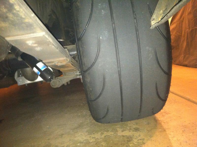

I have the 5.5 backspace. I bought the wheels from a place called The Mopar Shop. I have to wait to get them until the 15th! Summit would have had them here today.View attachment 198011

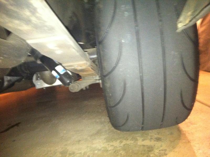

Got my 295 55-15 tires mounted on the OEM Mopar steel 10"x 15, 5'5 backspace and they are a perfect fit! Thanks for the input guys...0715141206a.jpg
